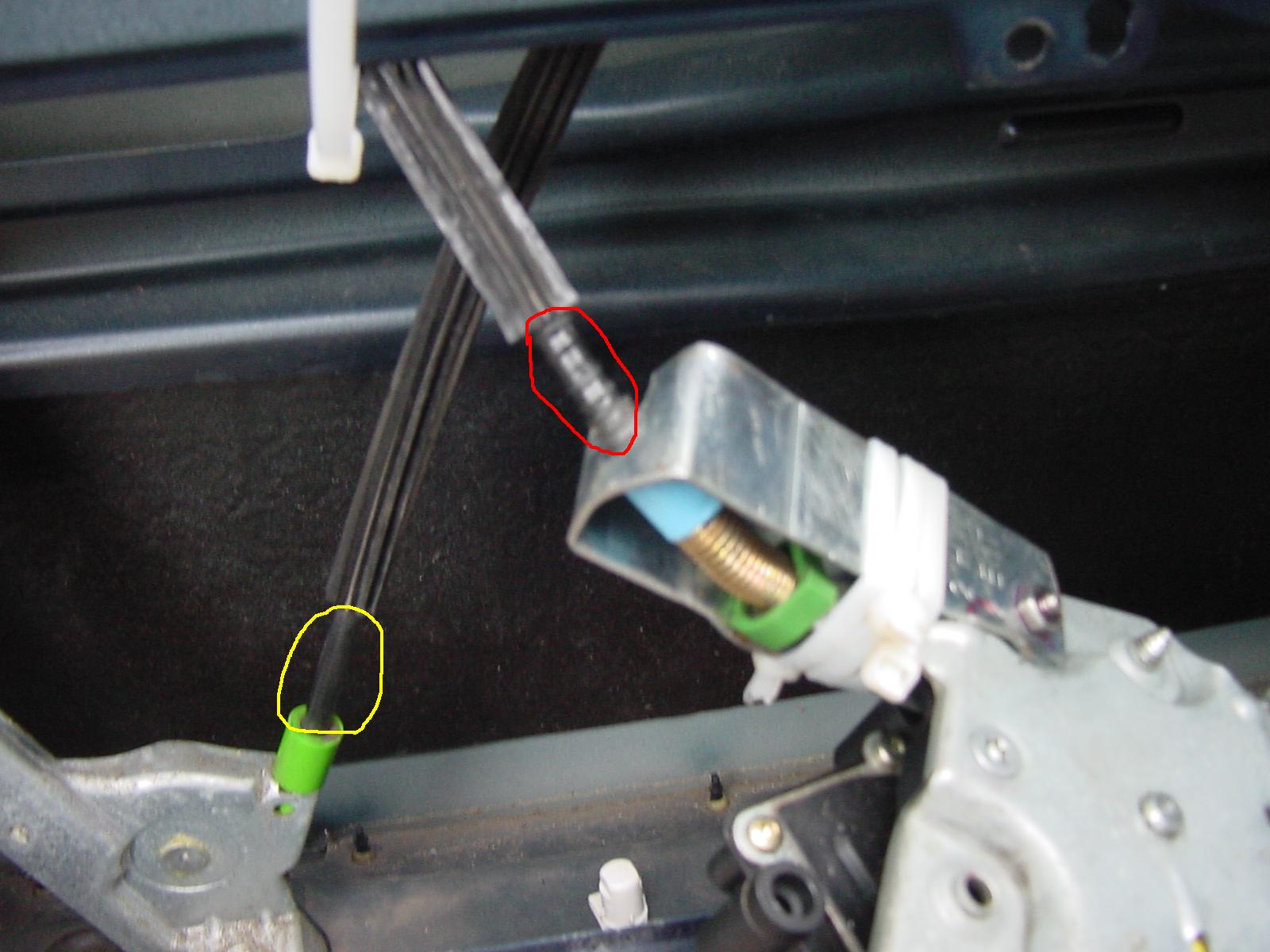

Dennis:
From your further description, it sounds as if you need a new window regulator (part # for driver's side is 996 542 075 04, about $160 from Sunset Imports).
Since you have the door panel off, check to see if the black plastic sheath that leads to the regulator/motor assembly has "crumpled" (If it has, it will look somewhat similar to when you push up the sleeves on a long-sleeved shirt past your forearms). An undamaged plastic sheath should be smooth, with no circular "wrinkles".
To get a good look at it, you will have to remove the three nuts that hold the motor in place and push the motor towards the outside of the door so that you can wiggle it down. Look just to the left of the (green on my 97) plastic sleeve on which the large brass-colored spring sits and you will see the 2 to 3 inch section of black plastic sheath that I am referring to.
Here is a photograph showing the "crumpled" section:post-6627-1190063459_thumb.jpg
The defective (crumpled) section is circled in red. What a normal section would look like is circled in yellow in the other part of the window regulator cable black plastic sheath.
Disregard the silver metal clamping piece I installed around it to try to repair the problem. It fixed the problem for a few months, but then the problem came back when it crumpled a little more. Not worth doing, IMO.
If that is what you have, then the overall cable acts as if were stretched (although actually it is the black plastic sheath that has shrunk from being compressed) and that is enough to not give you the 1/2 inch drop when you pull on the handle. This is the case when, as you describe, you hear the window motor being activated, but there is no corresponding movement at the window.
Regards, Maurice.
