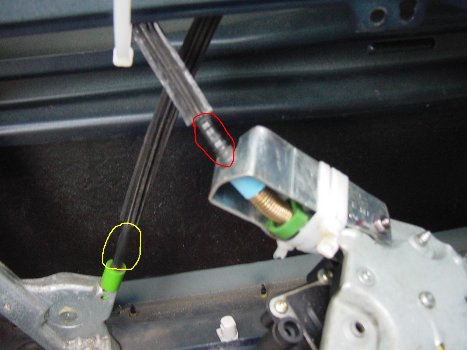

What goes wrong with the regulator is that the outer (black plastic/rubber) sheath that the inner metal cable slides in actually stretches and crumples in conjunction with the "damper spring" located on one leg of the flat triangular metal regulator body onto which the motor is mounted. Also, sometimes the plastic sleeve that the damper spring presses against sometimes cracks or a small piece of it splits off.
As the stretching and crumpling progress, you get less and less of that magic 1/2 inch retraction. More often than not, it will happen in sudden small steps or even in one sudden step. This is also sometimes combined with a stretching of the inner metal cable.
Here's a photo of one variation... The crumpling of the outer sheath.post-6627-1191390408_thumb.jpg
The red circle shows the crumpled outer sheath. The yellow circle shows a "normal" outer sheath at another location. Disregard the metal clamp/contraption. I devised that to repair my regulator. It only worked for about a month. Not worth the effort, IMO.

Remember, before you unbolt the two nuts that hold the two regulator legs to the bottom of the door skin, be sure that on the inside you mark the position of the "feet" of the legs where they rest on the bottom of the door (with a Sharpie Marker or similar). You can almost see the "foot" of one of the regulator legs in the photo I posted above, just below the metal part that is below the yellow circle in the photo.
When you reinstall the new part, that will save you from having to adjust those legs back and forth, as they affect the inboard-outboard angle that the surface of the window adopts as it goes up and down.
