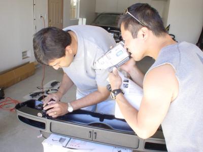

The local group filmed several of these installs when we were making DVDs. Raman has done about 6 rear speaker installs. We filmed him. At least one of the installs made it on the first DVD.
