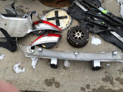

Are these Boxster parts?

I figured I'd take a ride (35+ miles to garage) to check on my baby.
BIG surprise.
I pulled in, did not see car (I was told in early December by the owner after informing him my car doesn't see the weather, is always garaged, and I had concerns about it remaining in a tight parking lot awaiting his next attempted fix)...so he had pulled it into an under the shop storage garage of sorts, never really saw it inside, just the outside doors under the back of the shop.....to appease me I'd think.
I initially went to drop off a new Insurance ID card as the old one was expiring and also figured I'd check in and see what was happening.
He told me he got the new clutch (last conversation the week before, after all the other stuff he has done which did not resolve the problem, so he said, "oh, I didn't know that this vibration issue didn't occur before the IMS work we did", and suggested he thought maybe it was a bad clutch.), and I said good luck, touch base next week, hope that fixes the problem.
On my way out the front door, I saw a buch up Porsche parts laying on the pavement in the parking area (picture attached), and a pickup truck with a boom crane on the back was delivering a junkyard Porsche motor. My heart sank. I thought the worst, but dismissed all negative feelings and went to lunch with my wife. It couldn't be my parts laying on the ground, could it? The motor being delivered couldn't be for my car, could it?
Needless to say, this gut wrenching feeling in my stomach said to go back after lunch and ask questions.
I did.
As I pulled in, the owner was in the front of the shop sweeping ice and water from the pavement. He glanced up to look as I pulled in, recognized it was me, and as I pulled in the back of the shop I parked my car and went up the rear entrance and entered the front of the shop. The owner was nowhere in sight. An employee came by me in a minute or 2 and asked if he could help me. I said yes, I was there to see Dave. He said who are you. I said Bob. About 1-2 minutes later the owner came out of the back of the shop (which is the entrance to the 2 bay garage) with a look on his face like I just caught him with his hand in the cookie jar. He looked like a scared cat. I asked what he thought the timetable for the car was, as it was going on 70+ days there. He walked into the back, pointed to the floor and said, "see, here's your clutch". I looked around, that motor was being worked on (the junkyard motor), and I heard a whirring of either a grinder or a wire brush on a pneumatic tool. As I looked at that Dave rushed me out of the shop and into the front office where I said "what do you think the timetable is and what's the story if this clutch doesn't fix the problem?"
He looked like he wanted to cry. He was all red in the face, mumbled something about the EPA and the DEP on his case, employee problems, problems with his daughter, family issues, being there since 5 AM, having work being backed up, trying to get away for vacation and that he can't tell me anything because he is obviously having issues (all blurted out in less than 15 seconds).
I asked about the Porsche parts on the ground and the junkyard motor, he said he had a Porsche with a blown motor that he was working on. Funny though, I re-evaluated the property before I left, not a single Porsche of ANY KIND on the property or on the lifts other than mine in the bay downstairs......uh oh? That was like a knife in my stomach.
I left, I tried to think that it could all be my wild imagination and not really anything to do with me.....but how, why?

post-70498-0-92889000-1391402905_thumb.j
