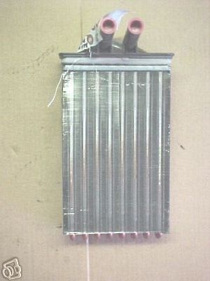

Bob:
I don't think the core would drain if you disconnect the hoses at the bottom of the engine because the inlet and outlet tubes for the heater core are at the top of the heater core. The only possibility (and I don't believe it would work in this instance) is if you can get an action going similar to when you siphon a gas tank and suck on the hose until you get the flow of gas going and then hold the outlet of the hose at a lower point than the level of the liquid in the tank. It might be a better idea to blow compressed air through the inlet tube behind the battery and seeing how much volume of liquid you get out through the outlet tube.
Here is a photo of the heater core so that you can get an idea of what I am talking about:
For reference, as you are facing the heater core in the photograph (which is the way it is mounted in the car if you are standing in front of the car looking towards the windshield), the inlet is on the right side, as should be confirmed by the arrows on the hoses behind the battery.
Also, the size is about 10 3/4" high by 6 1/4" wide and 1 1/2" thick.
I agree that you should only use distilled water to dilute the pure antifreeze.

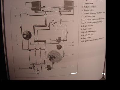

Bob:
Here is a diagram of the cooling system, with the components numbered and identified:
If you click on the photo to blow it up, you should be able to read the numbers, etc.
The arrows also show the direction of flow of the coolant.

Maurice....Thanks. Interesting diagram but I'm not sure what some of those lines are or do. Do you suppose that ATF relates to an automatic transmisson? Mine's 5-spd.
Is that a Bentley manual? Pretty good detail....much better than the Porsche disc at a glance......perhaps I need one.
But I still can't firure where the gallon+ is tucked away. It's full of water now and is cooling down. Tomorrow I'll try to find time to drain it again and measure the "catch".

Bob:
Bob:
Yes, the Porsche factory manual is written in a very cryptic style and is sometimes hard to understand.
You should definitely get the Bentley manual, it's a good investment.
The ATF does refer to the Automatic Transmission Fluid, it's just an extra loop, and you can disregard it for a manual tranny.
At what points are you draining the coolant?
Are there drain plugs at the bottom of the left and right radiators (like the drain plug in the center radiator in the "S")?
