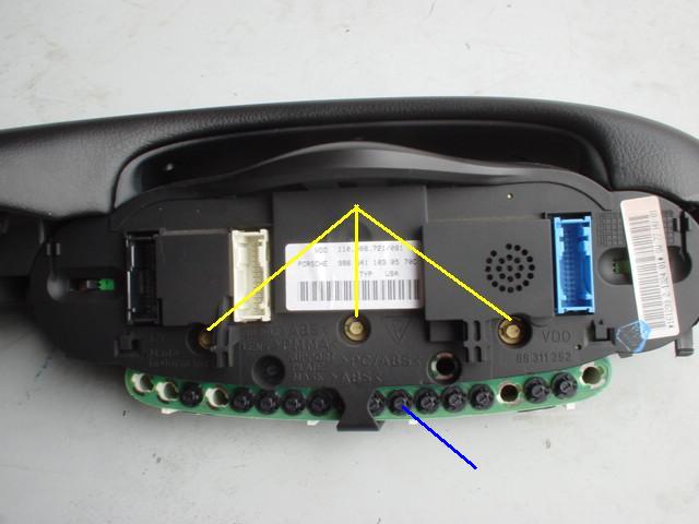

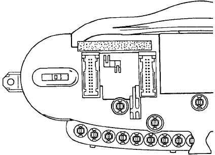

(ToolPants's bulb pic)
The warning/idiot lights have a black holder and are 1.2 wats. The LCD illumination bulbs have a tan bulb holder and are 1.5 watts. Loren has the part numbers. You can remove these from the back of the cluster
The bulbs that light up the analog gauges are 3 watts. They have a green holder, which is not part of the bulb, as you can replace just the bulb. But to change these you have to open up the cluster to get to them.
I also have not been able to find the first two style bulbs at local car parts places. We have had reports that they are also used by BMW and Volvo. The Porsche instrument cluster is made by VDO and I suspect they make clusters for other car companies.

The tan one below the blue connector is the one I need for the LCD backlight and the I need one black one for the seatbelt.

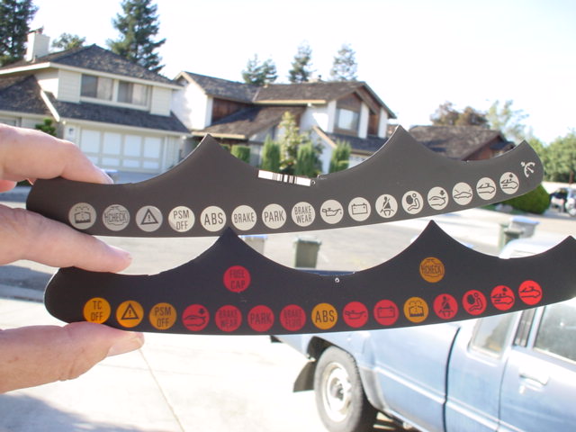

Jeff, the pic above is confusing a bit. Maybe its a ROV vs US change.
But on my dash tke 4 blulbs from the left (looking at it from the back like in your pic) are Cab top warning, roll-ver protection, airbag, seat belt. I guess this pic is from a none-cab dash pod. But where is the seat belt warning lamp?
Anyway many thanks guys.
My picture is a US Boxster for reference purposes. I put the blue line to no particular bulb - but I think I happened to use the ABS. Have no idea which one is for the seat belt on a UK car but if you send me your cluster I will take it apart for you.

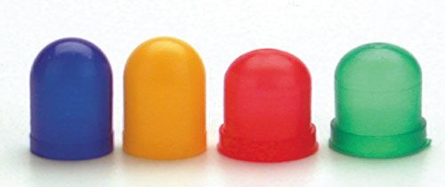

I just swaped the instrument cluster on my old Toyota truck. At night the illumination is green. The clear bulbs have these little rubber green covers. Same illumination bulb is used by Porsche. I have seen these covers for different size bulbs at the auto parts place. Also saw different color bulbs.
So you can change the color without switching to LEDs.
