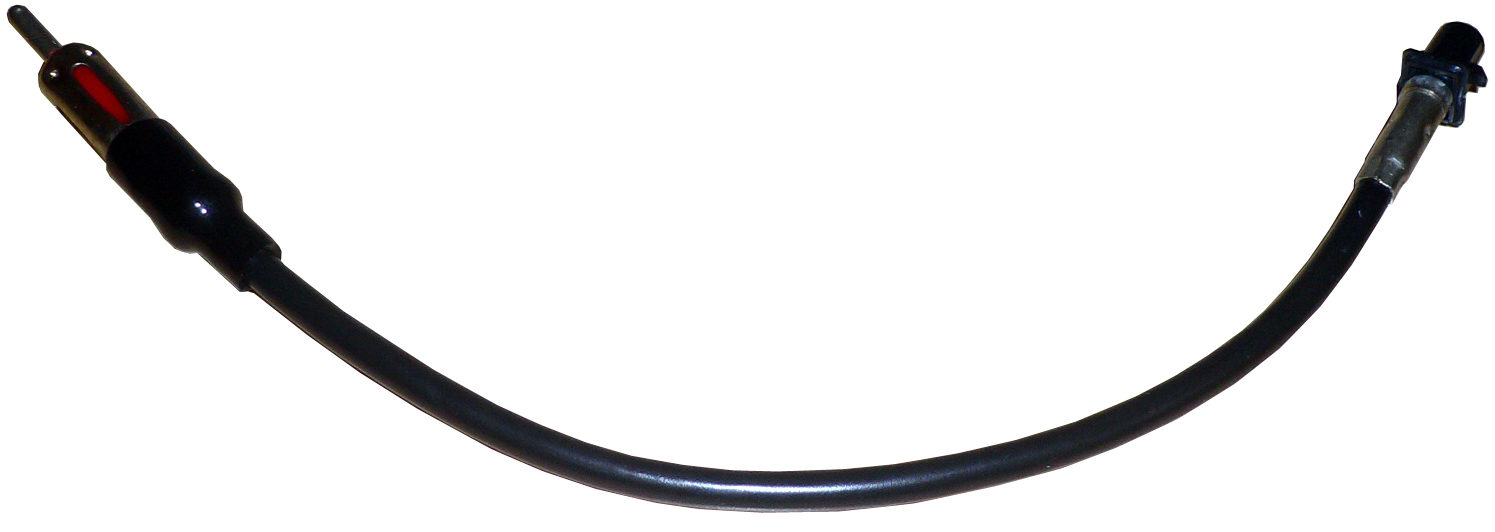

Also my radio antenna connector is a very small mini-"BMW"-type (not standard motorola, or even the standard larger "European" antenna connector.) Is this the same in the USA as well? So is this connector included in the kit? Thanks!

Heat Shield, Complete Wiring Harnesses, Antenna Adapter & Radio Removal Keys

I used only the antenna adapter and used only the top strip of the surround.
