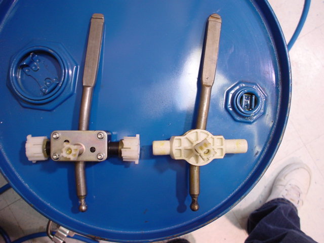

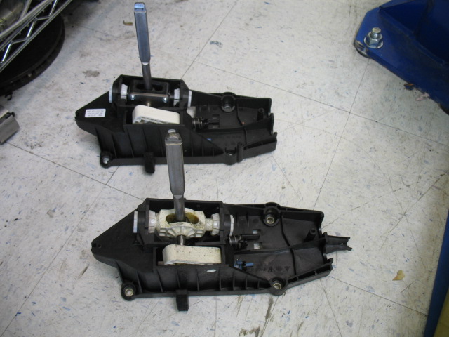

There are many messages on Rennlist and other boards about this. Putting the standard 997/987 shift in a 996/986. People claimed the 997/987 standard shift has shorter throws. I did not believe it because I saw both side-by-side and only saw a cosmetic difference - could be my eyes. I asked them to measure the before and after throws to rule out subjective options or "feelings."
They did and reported about a 10% reduction. When the 987 came out Porsche said it had a shorter throw. I thought it was due to a change to the transmission, not the shift lever. So maybe it is the shift lever after all. This throw reduction, if true, is less than all the aftermarket short throw shift kits on the market.
If there is a local owner who wants to try it then let me know. I will measure the before and after throws.
