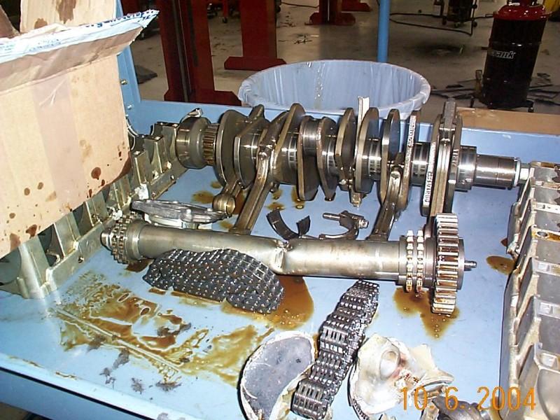

How can we prevent this IMS failure? How about tapping the suspect bolt and installing a larger one with some loctite? Or maybe have a toolmaker fab up some higher grade bolts like ARP?
I would love to have some peace of mind, so please chime in and tell me what's actually breaking? What's the diagnosis?
Edited by demonz
There is a bearing on the end of the shaft. I have been told Porsche went from a double to a single bearing. I was told the year but forget - I think 2001. This is why you seldom hear of intermediate shaft failures on the older cars.
Picture is a 2003 2.7.
