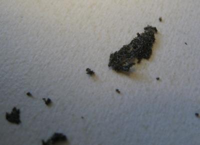

My '99 C2 is blowing some sort of disintegrated filter out of the vents when the fans are cranked. Any one else seen this? It's small peices (maybe 1cm x 3mm bits) of a black material. It's been happening since I got the car, and doesn't show any sign of stopping, the dash is covered with very small particles of it after each journey, with maybe a few larger pieces. The vents also have quite a musty odour coming out.

Are you sure it is filter and not the foam insulation inside the housing?
Check with the car/fan off.
If the charcoal mesh was really old and started disintegrating it would just fall right down in to the duct work on the 996, there is no way to prevent this. If it appears thats all it is, you can try to remove the accumulated debris by sticking a vacuum hose in the intake under where the pollen filter is, and maybe get some of it up. That would suck if it was that, because in order to get through to inside the cabin, it would have to be clogging the evaporator. You should be easily able to tell if it is tiny bits of charcoal. if it is REALLY lightweight, fluffy kind of stuff, though, then by the way you are describing it, especially with the musty odor, I'd bet you have a black mold on the evaporator, usually from a clogged evap drain line line not allowing it to dry out, The black particles you see is the bits of the "blanket" of mold tearing off the evap and blowing into the car. It shows no sign of stopping because it just grows back. I'd take the car to an AC specialist to have the system sterilized and the drains cleared. Then use some spray AC disinfectent on a regular basis. Any good automotive AC specialist will know exactly what I am talking about. Fairly common in hot, humid places like Miami & Houston....one of the nice things about dry heat in Arizona...never see that problem. We see it here ocassionally in Virginia.

You know, I'm not sure it is mold. Here's a picture of a larger part. The big bit is about 7mm long on it's longest side. Maybe there is mold (it's definitely stuffy for a bit after start up), but I don't think the big chucks are mold. Looks like filter material to me - what do you think?
-James.
I agree..that's not mold. It's definitly this...The musty smell is because the AC is ineffective due to the large holes in the flap door. Loren was correct...again! Good fix at this link. http://www.carboncow.com/pages/porsche/heater_door.htm
Yup foam that has broken down! I hate the stuff! You need to get that stuff out of there. It gets real sticky and will bind the air system divertor doors. You then may be complaining of certain vents or AC and/or heat not working correctly!.
