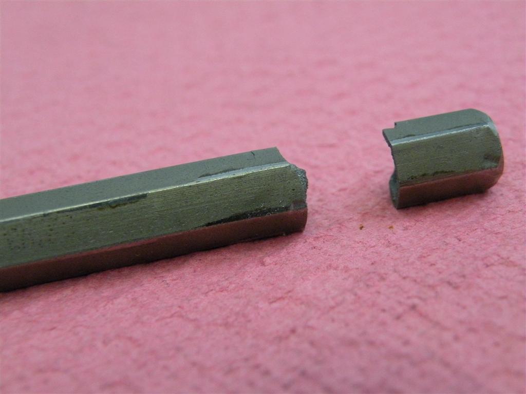

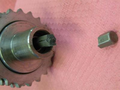

Broken oil pump shaft/ motor over rev

This is becoming a more common problem.. It recently took one of my engines out of service and accounted for our first failure.
The answer is a billet chromoly replacement part thats total overkill.

Am I looking at the hex pin from the IMS to the oil pump?
