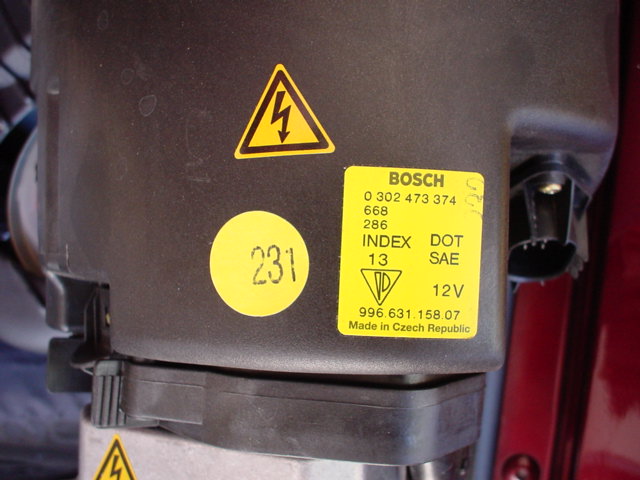

Can you tell me if this litronic headlight 996.631.058.01 is a normal Xenon light or a BI-Xenon(also high beam Xenon light)
Thank you for your help
Are you sure about the part number? It is not in my price list. There is a 996.631.158.01 though?
Another possibility is that that number has been replaced with a newer number (but quite some time ago as my list goes back to 2001).
There are some differences in the part numbers between cars delivered in Europe and USA. The number above is a European number for a Litronic headlight, but I don't know if it's a BI-Xenon headlight or not.
When was the BI-Xenon light introduced in the Boxster?
I did look in the RoW both and US/Canada parts lists...
To my knowledge the Bi-Xenon has never been introduced in the Boxster (at least not yet). Litronics have been a Boxster option/retrofit since MY99.
You were right Loren, there are no BI-Xenon headlight for the Boxster. This is an information from my local dealer.
The part number must have been replaced, but that is not so important for me, the main thing was about the BI-Xenon.
Hallo
I checked the part numbers and I found out that I have made a mistake. The right numbers are: 996.631.057.01 and 996.631.057.02
Do you know about any differences between the number you told me above and these.
Both should be Xenon headlights, perhaps the number was changed but technically they are identical.
Turro
I want to retrofit Litronic headlights. I got the numbers from ebay auctions. There seem to be two different part numbers, and I first thougt that one are BI-Xenon and the others normal Xenon.
I would like to know if I can buy two headlights with different part numbers and build them into my car.
But when you can not find the numbers, then I don't know where the people selling the headlights get them from.
Litronic is a trade name from Bosch or Porsche for xenons. Bi-Xenons came out in 2001 for the turbo and in 2002 for the 996 as an option. Those are made by Hella. There is no such thing as Bi-Xenons for a Boxster as the shape of the headlight is different, unless you retrofit the front of the car to make it look like a turbo/facelift 996.
Have the seller send you a picture of the part number and then we can figure it out. For litronics it will start with 996, but they also fit a 986.
Also, you may need the headlight washers to pass inspection. This is covered on the German Boxster board. It depends on the year of your car.
