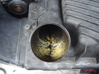

does this mean my engine bore liner is cracking
1999 c4 cab gone to dealer to sort out tip issue but thats a whole new topic which is already posted .
however my water expansion tank seems fine only red colour antifreeze present but when you remove oil filler cap you find small amount of milky white stuff on the fill nozzle and behind the yellow oil filler cap is this normal condensation >??
or is it early signs of porous bore liner problem ??
your input would be appreciated car runs fine at the moment no over heating etc ....

Your picture is quite normal, more miles driving means less of the mayonaise.
This is caused by frequent short runs in which the engine gets a short time at opperating temperature and is shut off, (short runs) this creates much more condensation, the condensation which formes droplets of water gets thrashed and mixed with the oil and emulsifies, then when the engine is at opperating temperature the moisture and emulsified oil becomes like steam, this then cools and forms the mayonaise.
Short runs need more frequent oil changes, not simply to prevent the mayonaise but because more moisture in the oil will cause the oil to breakdown a little quicker.
Oil has antioxidents and they have to work harder or become less effective the more moisture is added.
Dont worry about it, your engine will not suddenly die because of it, it is perfectly normal
