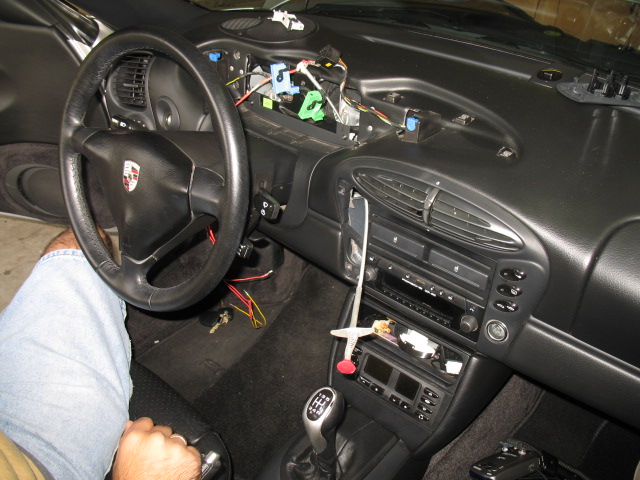

Ok, I confess. We have done 2001s before. Started doing them 7 years ago.
Here is a picture from a few months ago of a 2001. On that car we did it with the switch because the owner has long legs and did not want to do it with the stalk.
With the advent of the MY01 Boxster, the instrument cluster changed fairly extensively. CAN Bus operations, display presentations, including the OBC display....if you had the factory installed OBC. The display went from lighted segment numbers (like the digital speedometer), to a dot matrix display which gave better resolution of the numerical display and the ability to display a greater range of icons and warning symbols. Regardless of the instrument cluster installed, the OBC can be "turned on" and displayed. For the owners who have MY01-MY04 cars, if you don't have option M659 you don't have factory OBC, but your instrument cluster can still display the OBC in the older, lighted segment format, i.e., Outside Air Temperature, Average Fuel Consumption, Average Speed, Calculated Range Remaining, Digital Trip Odometer and Cruise Speed Over-speed Signal. With the exception of the Outside Air Temperature, all other displays can be reset to zero. In the case of the Over-speed Signal, it can be set to a desired speed or turned completely off.
