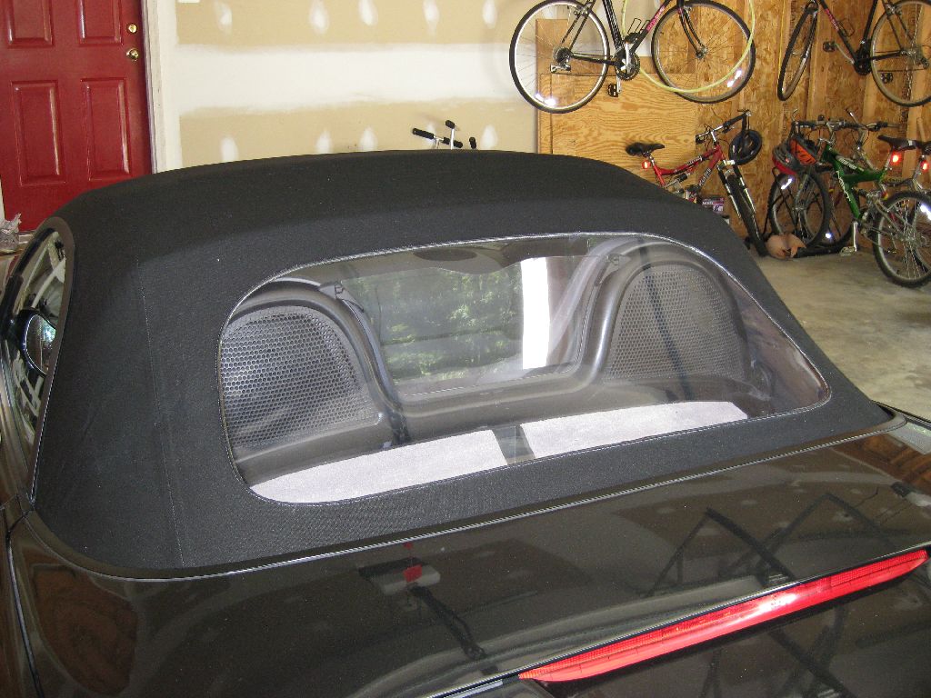

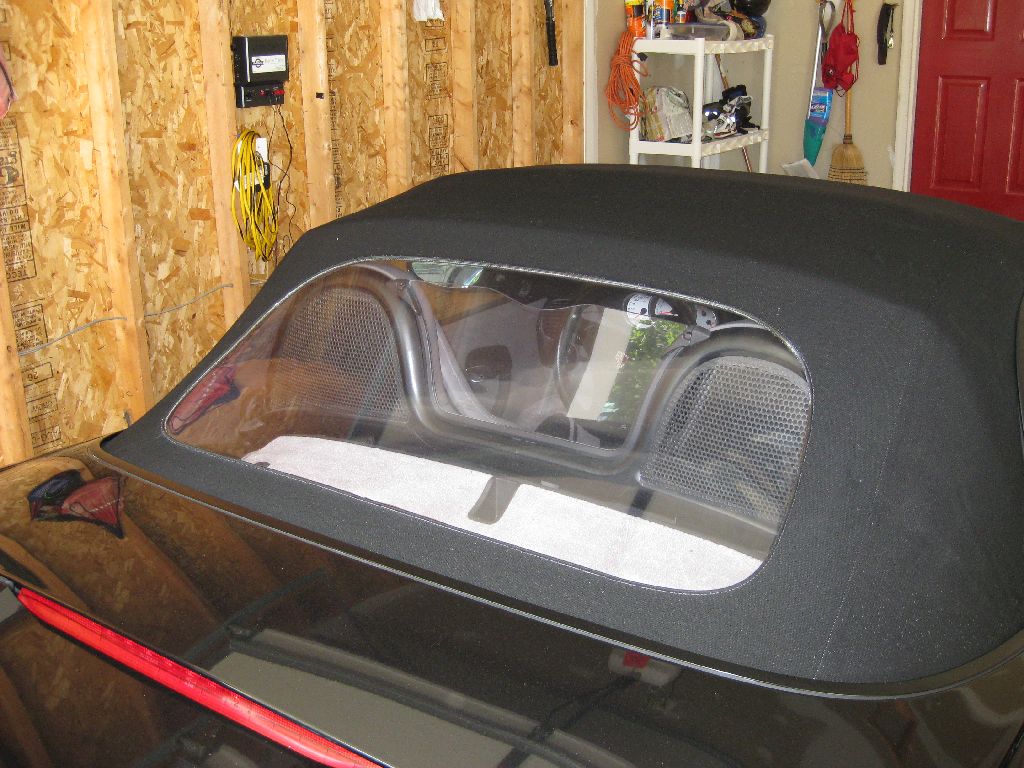

Finished it up this morning and it really looks good. Thanks for all the support - it's pretty great knowing there are experts just a few keystrokes away!

Sorry it took me a while to get to this, but I can't figure out how to upload photos - when I try it tells me I can't. If you can clue me in, I'll put some up. The way they did it was similar to the method the guy at emiata uses on his kits - took a template from the original window without removing it, sewed the new one on over it, then cut out the old window. It leaks very slightly if you really hit it with lots of water and I am going to try to figure out a way to seal the seam, but the leakage is so slight I am not really concerned (at least not yet...).
Figured it out - my photo editor program was saving the file as .bmp but when I changed to .jpg it uploaded fine. So here are the after shots...
John:
The photos look fantastic. It looks like a brand new top and I'll bet it has rejuvenated your car's appearance by quite a few years.
Thanks for sharing the photos.
Regards, Maurice.
