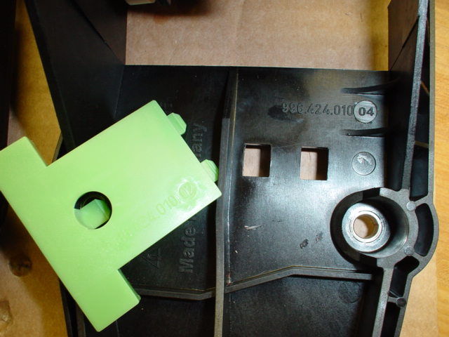

Did the 9x7 shifter (standard) swap today and love it. Just one question... I tried moving over the green plastic "plate" that was under the black shifter cable, but I felt it was in the way so I removed it again. Is it supposed to be on or off?

Usually we leave it off - it odes not seem to fit on the 997 shifter or the B&M installs. It's just a coin/debris guard anyway. Older cars never had them to begin with.

It was there on my 1997 and the great write up I mention above never covered this removal need so I scratch my head for a minute or two. I guess we all find this out the hard way when we see the right cable start smacking it right away!
I didn't see it as a coin/debris cover as much as something for the stock shifter to lay on when moving front and back. maybe to keep it snagging? I looked it up (as it clearly has a number on it) hoping to see what Porsche called it, but there was no description.
I suggest you not throw it away. I noted it was superseded by party number SS 98642401003 and is retails for $182.49!!! Mine now hangs in my garage to make my friends laugh when they ask if my Porsche is expensive to maintain. I point to my little green piece of plastic and ask them to guess how much!
The green plate has a part number on it, and that part number is for the 5 speed. If you remove the plate then under the plate is a part number in the black plastic, and that part number is for a 6 speed Boxster or 996. On the 996/986 only the 5 speed Boxster has the green plate. Remove the plate and it is a 6 speed part. So the price for the part number on the green plate is actually for the entire shift housing, not the plate.
No clue what it is for. I have asked mechanics and they don't know.
