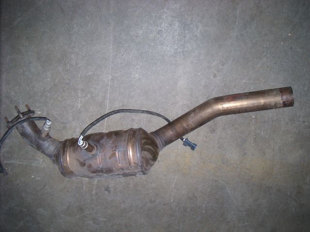

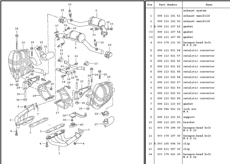

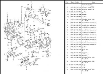

another issue is that i have look over the 2nd sensor for bank 1(driver side wich actually end on passenger side) and surprise.
on both pipes after the exhaust mainfold is only one.is the "before cat "sensor,so there is only 2 sensors and not 4!!
do you think that on my model year is possibile that the 2 nd sensors to be located somwehre else?on the porshe diagram parts i have seen them related to be on the straight pipe after the cat
based on the p0139 code i have made a search and found have found a nice deal for 996.606.178.01 sensor but i can not locate him so far(item number 30 in the image)
i repeat,on the straight pipes after the cat there is no sensor at all!i have just look for 30 min in that area from the cat untill the exhaust canister.

just that instead of the after cat sensor( 30 in image ) the pipe is straight with no hole no sensor nothing.
do you think it is possibile to be in the exhaust end canister?
very curious since i get an fault code for this after cat sensor
updated,here is the o2 sensor location
