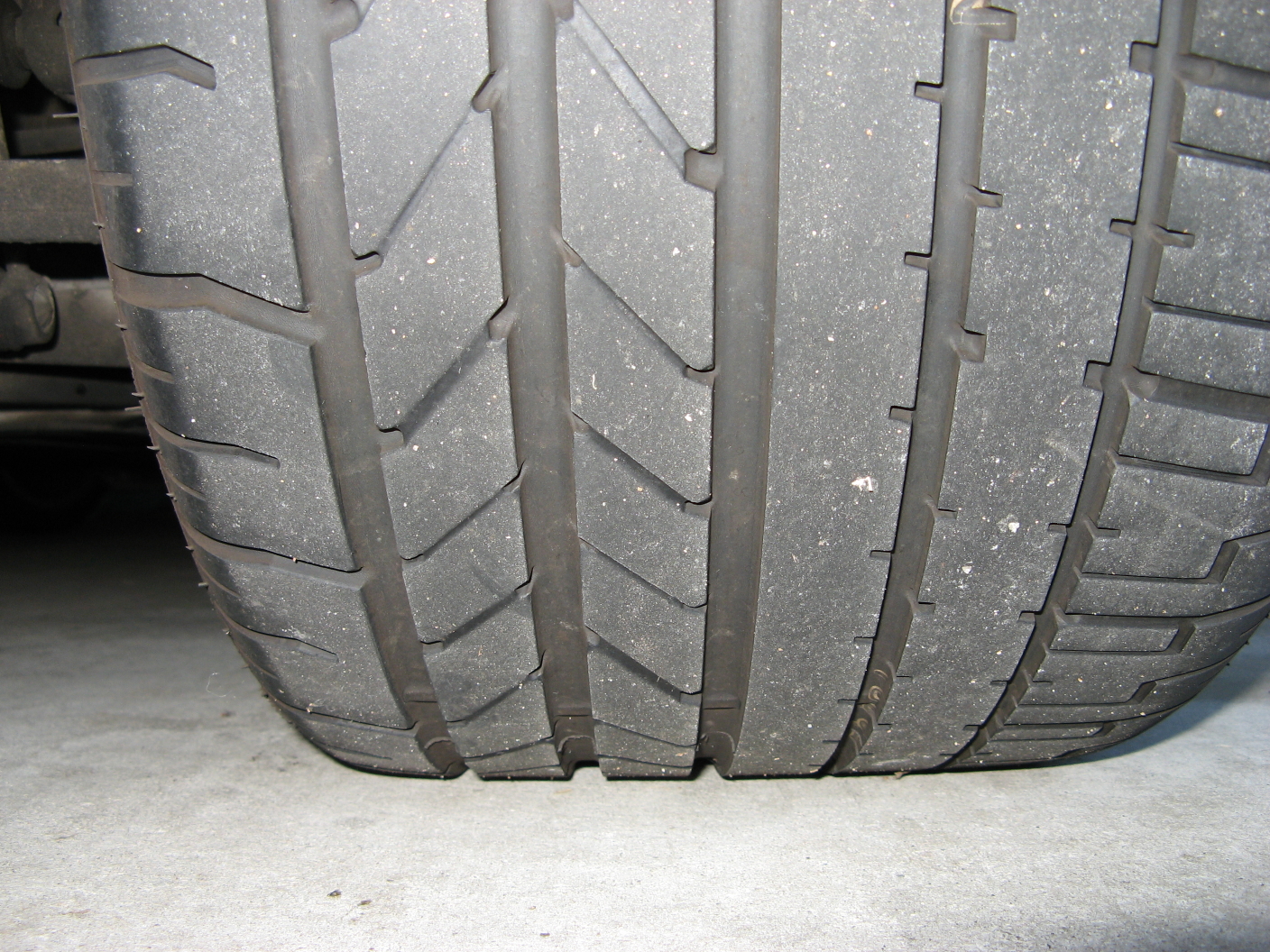

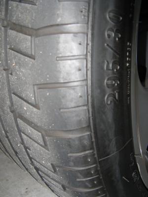

Paul - I've attached some pics, but not sure that the uneven tread wear can be seen very well (the pics are of the passenger side rear; the driver side rear is similar wear)

Those look normal. The outside shoulder appears to be solidly tie-barred between the lugs. To measure tread depth, you need to use a gauge in the major circumferential grooves; from your photos, the wear across the tread looks more-or-less even. If anything, the inside looks a bit more worn to me than the outside.
--Brian
Edited by Q-Ship986
The outsides look just like glazing. This is normal and
nothing to worry about. The gage is the only way to measure
when you have so much rubber left on your tires. Show us
some pictures when you get another 6,000 miles
on your tires and then you can look at the rear. In
my world of throwing the car around, these tires look new.
Paul

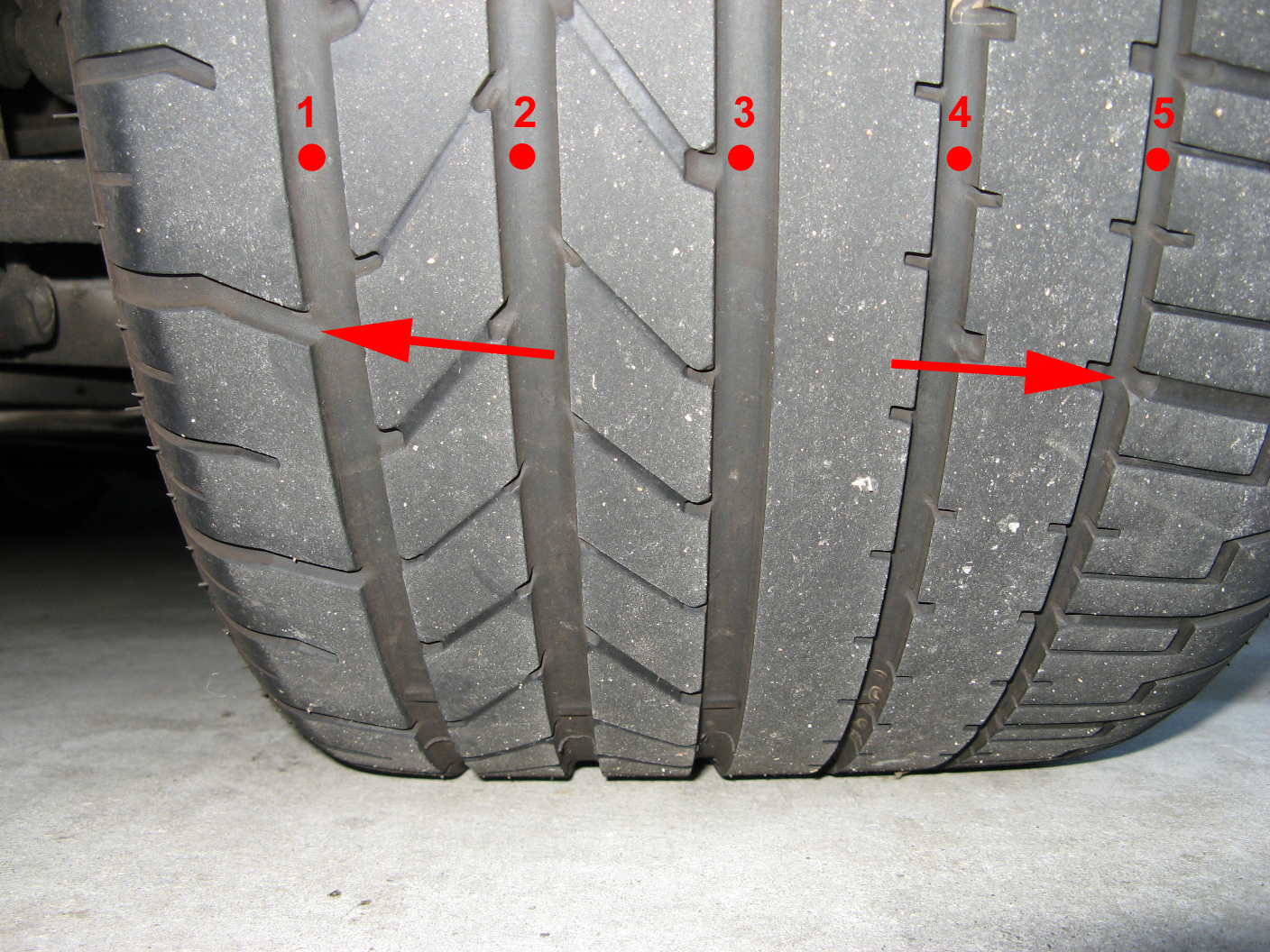

An alignment check is probably not a bad idea, but again, the wear of the tire in your photos not only looks typical, it looks like it is wearing more on the inside portion of the tire. For comparison, I think you may want to look at a new PZero Asimmetrico:
If you get a depth gauge and measure the tread depth in the slots as I have marked with dots on your photo below, you will probably find that the outermost groove (groove 5) is deeper than the innermost groove (groove 1). I think you must be hung up on the difference in appearance of the lateral slots marked by the arrows. The outside shoulder rib has a shallower skid line, which means the lateral slots are not as deep as other slots on other ribs. Note the way the outer shoulder slot is "stepped up" from the groove. The outer skid line tapers to even shallower depth as it approaches the arc point, which is the end of the tread at the outermost edge. This is all typically done to enhance handling performance. Less tread depth and rubber mass increases block stiffness and reduces hysteresis to prevent tread chunking, among other things. Most important on the outside shoulders which endure the most stress/strain under cornering.
Hope that helps.
--Brian
