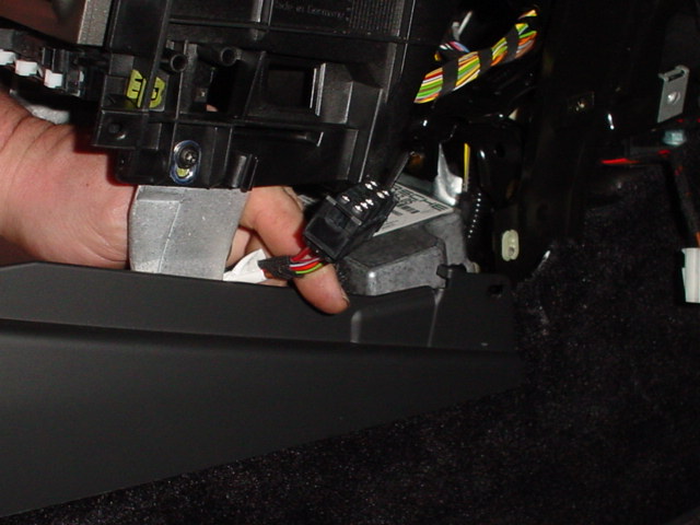

The control unit has its own fault code. I have seen a few being replaced at the local dealership over the years. Pic is from over 3 years ago of an almost new 987 that was having the unit replaced. It is where the finger is - same location on a 986.

The unit in the photo in my 986 is the airbag sensor. The dealer said replace the control unit (octantman edit: the airbag sensor, triggering unit, and ECU are all the same item with different names, sorry). I asked for a cost breakdown, but they have not even honored that. The $1,500.00 was a verbal quote over the phone.

Yes, after inquiry the dealer produced 3 sheets of the bulletin in defense of having recommended replacing both buckles, wiring harness and the control unit. My bad on the previous post about the triggering unit being under the seat..of course that is not true, that is the alarm ecu. The TSB states that before 2000, and certain VIN's, replace the buckles and wiring harness...and the ecu only after repeated warnings. After certain VIN's and model year 2000 onward replace the buckle and it does state replace the wiring harness. The TSB is dated 1/04. The offending ecu's are part number 00, the ones made as of 2004 are 02, and mine is an 01. If the light comes on again (only happened once so far) I'll replace the buckle. Are there instructions out there as to how to replace the wiring harness? The new buckle, a 1/2008 mfg has the blue 4-pin plug on it with longer wiring. My original buckle plugs into another harness under the seat which in turn has the blue 4-pin plug on it.
