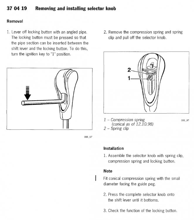

Removing:
Lever the locking button A off with a suitable tool or finger. The locking button must be pressed so that the tool can be inserted between the selector lever B and locking button. (The ignition key must be in position 1 before the locking button can be pressed.)
2. Remove compression spring A and pull spring clip B off toward the rear.
3. Pull selector lever up and off.
Installing:
1. Assemble the selector knob with spring clip, compression spring and locking button. Fit conical compression spring with the small diameter facing the guide peg.)
2. Press the complete selector knob onto the shift lever until it bottoms. The spring clip must fully engage in the slot on the selector lever.
3. Check function of locking button.

Removing:
Installing:

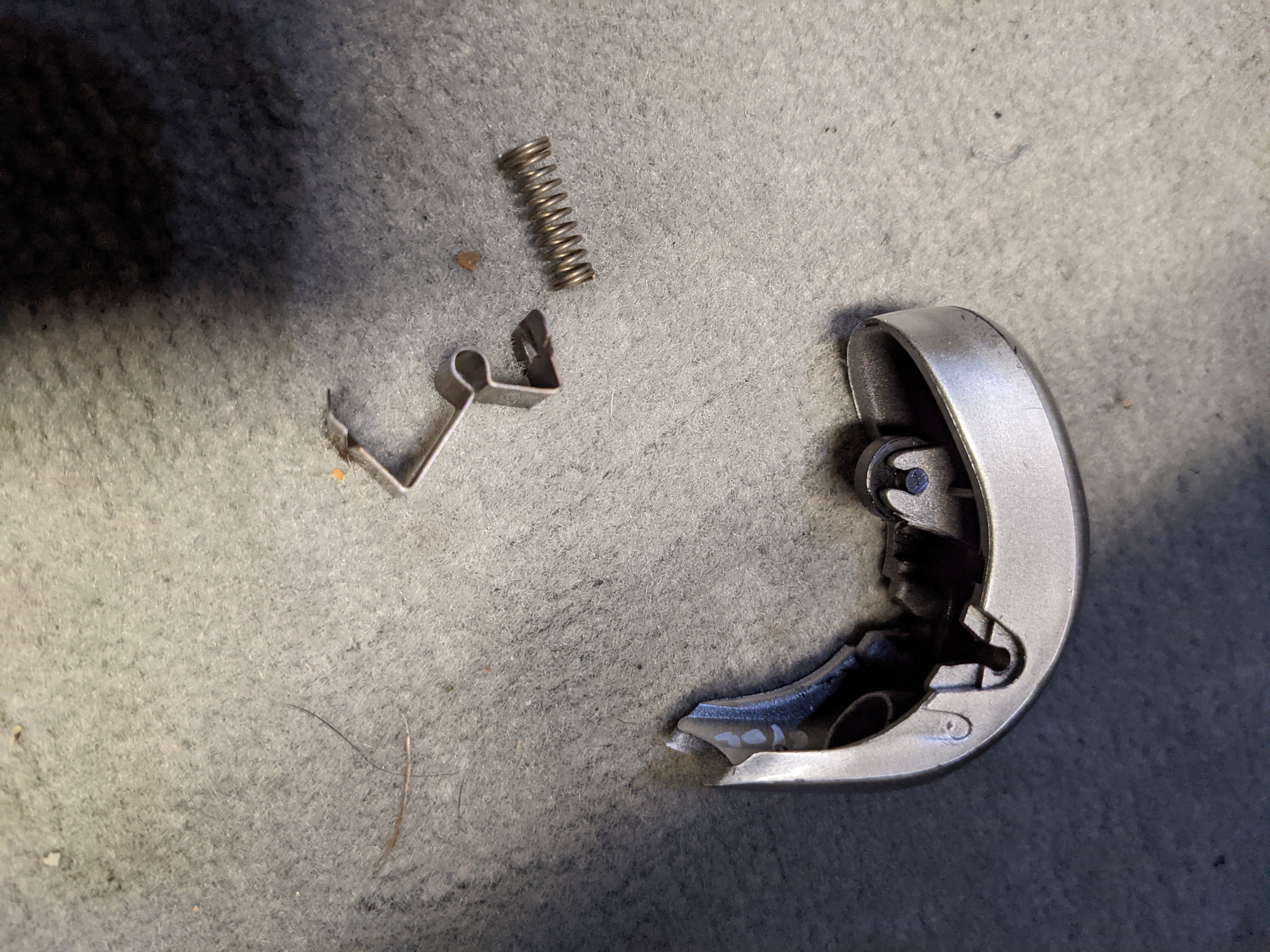

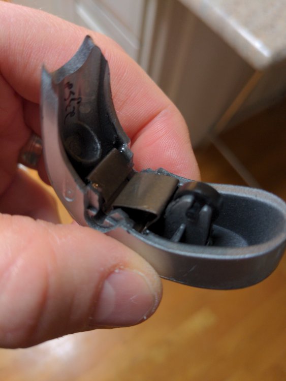

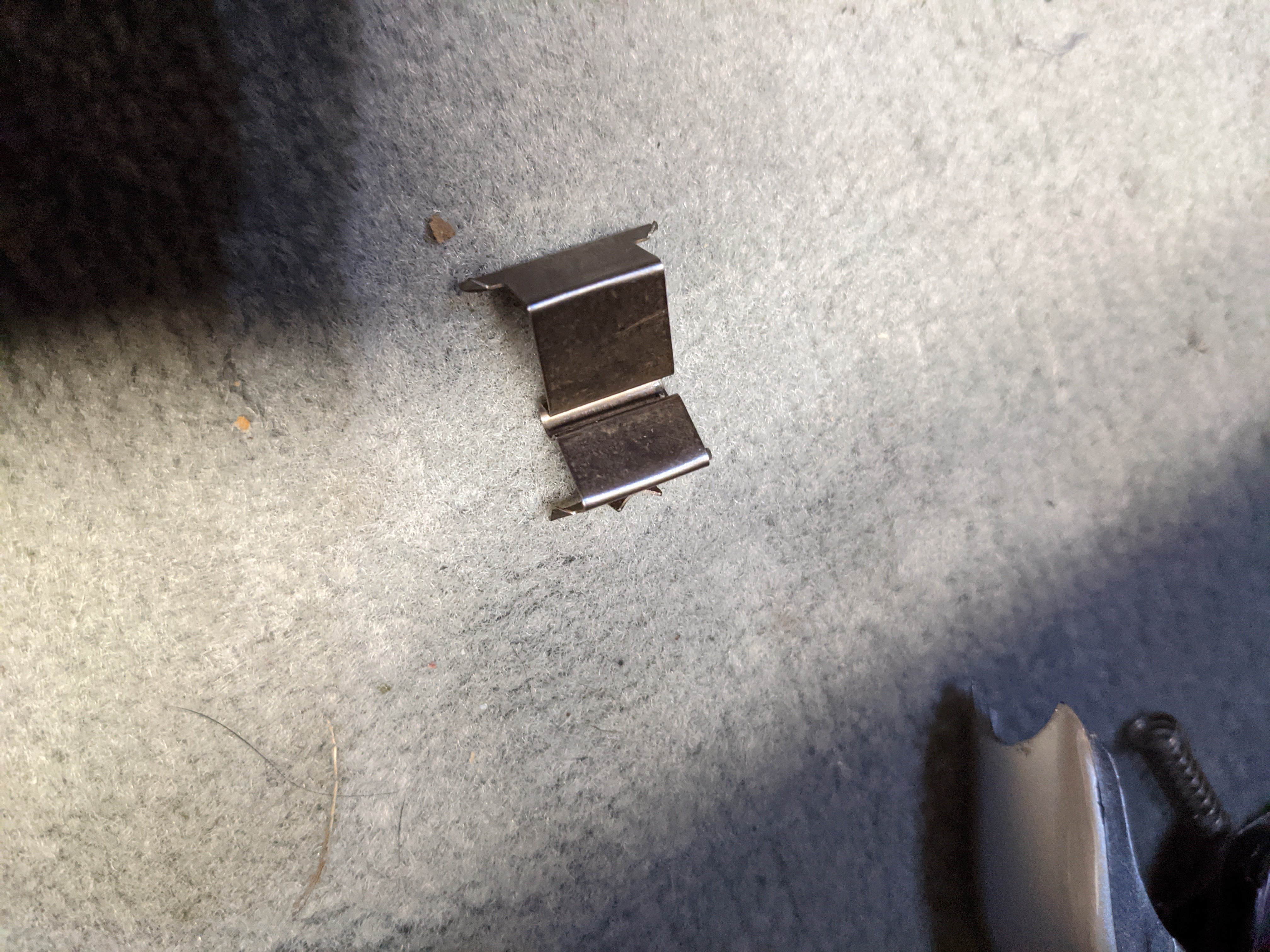

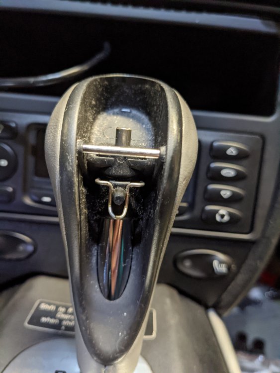

On 12/19/2020 at 5:05 PM, buckeye96 said:
For anyone else trying to fix their tip shift knob. That metal pieces goes in the knob.
Awesome - just had a similar problem where the spring clip had worked itself lose inside the button, so used some pliers and a screw driver and as per your picture above managed to reseat it properly again - many thanks!
