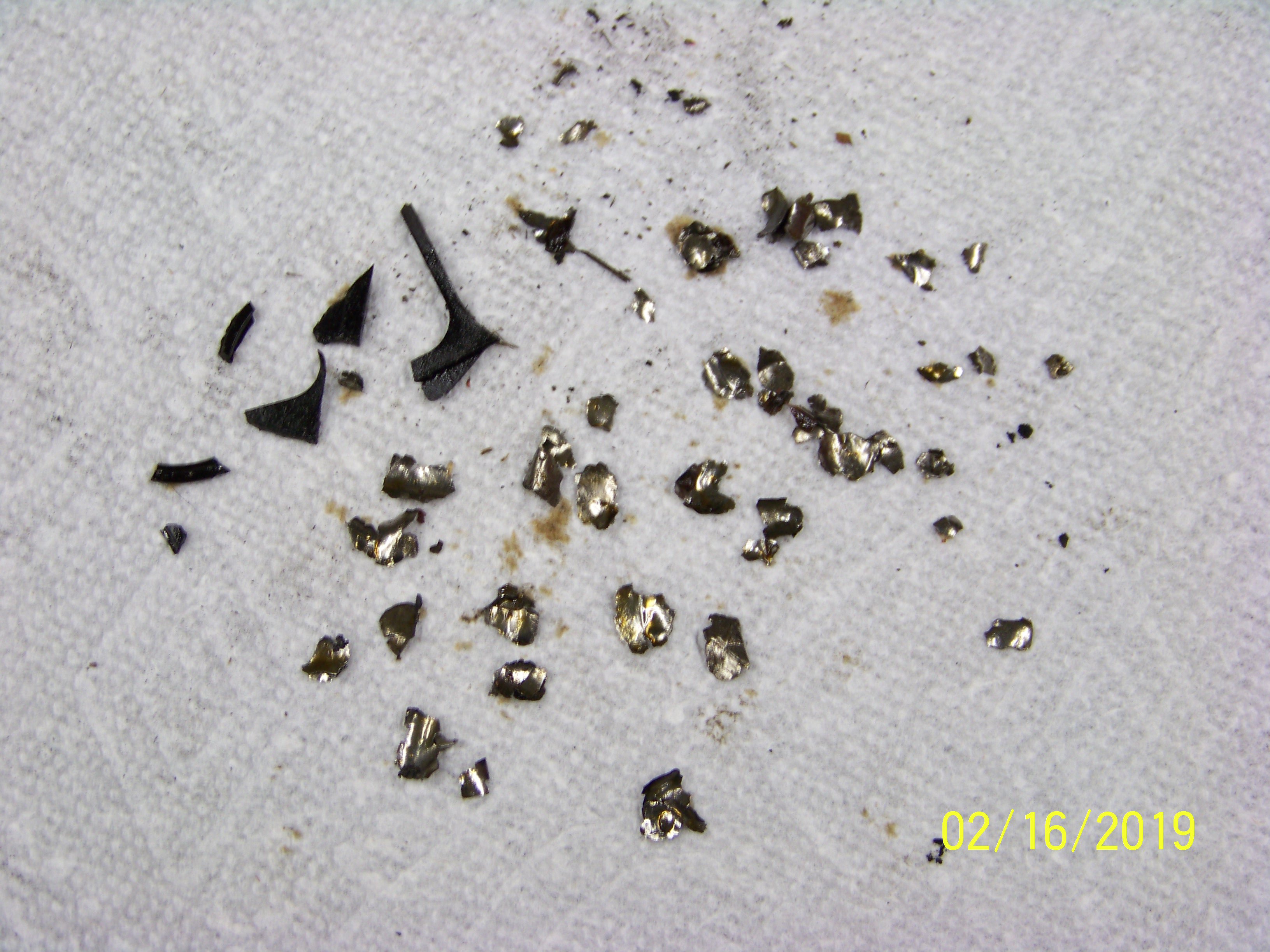

First off, if you are the original owner and if you changed the oil every 5-6K miles (less intervals than what Porsche recommends @ 15k) and you have been using top synthetic oil, I suspect you may never have an IMS bearing issue ...
Stats are great, but as most cars will go through multiple owners, one will rarely know the history of who & how the car was driven as well as how faithful they where at oil changes.
This '97 Boxster M96 2.5  I recently purchased ran fine with no irregular sounds, no signs that would warrant concern. Probably the best advice on the net for these cars is have the oil pan removed and inspected for peace of mind. If there is a possibility IMS or other related failure, chances are there will be debris in the bottom of the oil pan. As well on my car, the debris had also collected on the screen of the oil pickup spout. Further inspection of the oil filter one could easily see the finer particles within the folds of the filter.
Yes I could run'r till she drops but at varying cost of replacement engines from 3 to 10K for a used assembly, I'd rather do the bearing along with any other warn parts now, rather than take a chance later on someone else's used engine with surprises. In fact this Body & chassis is so nice, I should price out a crate engine from Porsche but I can just imagine what that may cost!!!  As a do it your'selfer, I am quite enjoying taking this thing apart, but there again I have a warm shop with all the tools, only thing missing is a hoist!
Attached picture is the debris in the bottom of my oil pan.
Cheers,
Mark
