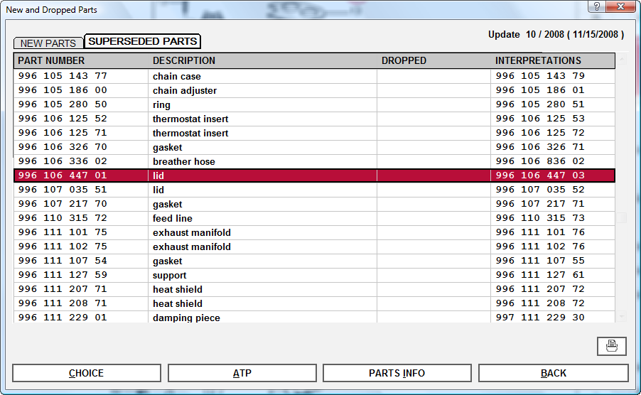

Can anyone verifiy that there is a new updated cap .03?
Sputter:
There was one that was on a new 2009 997 with PDK transmission at the dealer about 1 month ago.
I have a photo of the .03 coolant reservoir cap but the photo upload feature does not seem to be working on Renntech right now.
I'll try to post the photo again later.
Regards, Maurice.
Yes from Sunset Porsche you can purchase the version .03 Cap
996-106-447-03 Coolant Reservoir Cap Was $18.87 Now $12.16
Select Porsche Parts at Dealer Cost at the center top of any screen in Renntech

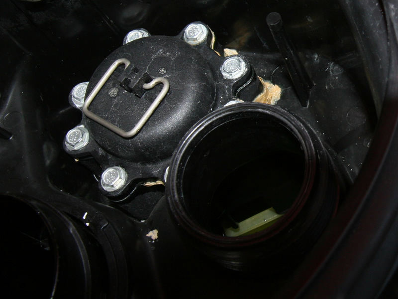

Hi, I also have this mist (condensation), even after I replaced my cap with a new 03 version. From my research on this board ( :renntech: ) this could be caused by worn o-rings on the bleeder valve housing. I have yet to verify that this is what is causing this on my car, but just wanted to let you guys know that the condensation could have other causes than a bad cap.

Atle:
If you have a new coolant cap and you are still getting condensation on the underside of the trunk lid, the problem is definitely in the bleeder valve assembly. It's either the o-rings or one of the two rubber gaskets that you will find in there. Sometimes the rubber gaskets get "warped" or get a pinhole in them.

It was not easy to get my non-macro lens to capture this, but as you can see there is a lot of yellow residue around the bleeder assembly. Better change out the o-rings and gaskets - and perhaps the entire assembly if its not too expensive? The residue looks yellow, as does the coolant. Is this normal?

Atle:
This is NOT normal. The entire assembly can be replaced, and it is not expensive.
However, since it's a relatively easy DIY, with easy access, buy the O-rings first and change those out. If you inspect the diaphram and gaskets and they are serviceable it will be a very inexpensive repair. If you still get condensation or leaking/residue, then you can change the entire assembly.
The only caution with this repair is to be very careful not to overtighten those long, thin bolts. They can easily shear off, and then it's likely you will need a whole new coolant tank.

Thanks. Is changing the entire assembly the same amount of work as just changing the o-rings?
Looks like a very straight forward DIY. http://www.renntech.org/forums/index.php?showtopic=14754
