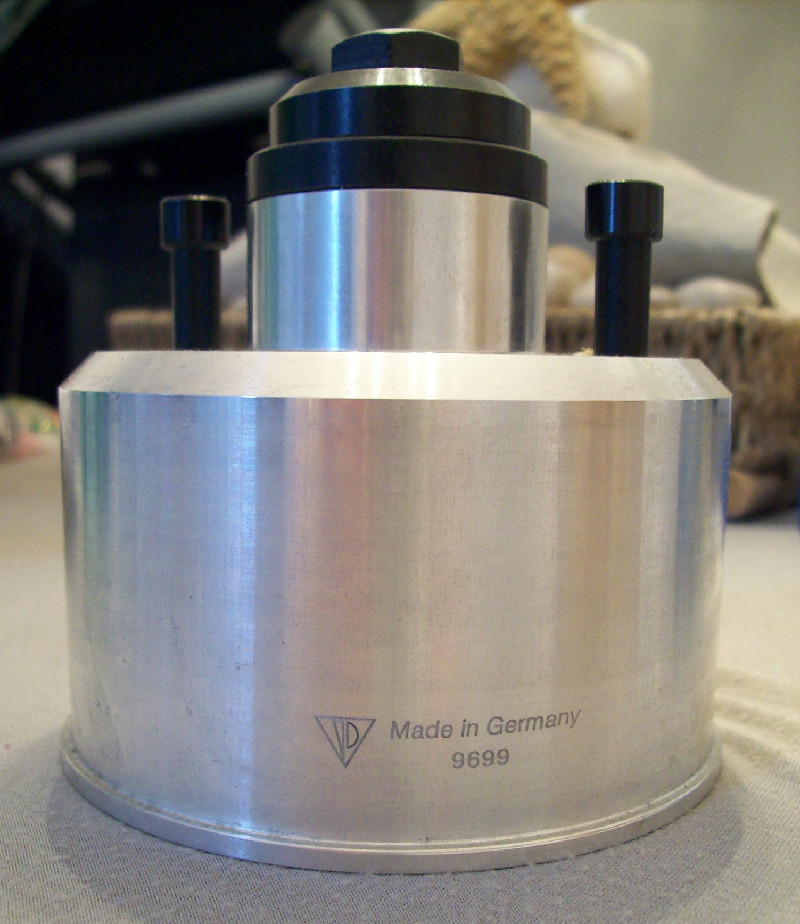

RMS Tool $242.44

BTW; Don't be surprised if you see one of these become available in the FOR SALE forum in a month or so. ;)
You don't need a RMS tool. ;if you're careful. just tap around the edges of the seal with a small rubber tipped hammer.....and make sure you don't push the seal too far in, another way is to get a PVC pipe the same size as the outer diameter of the seal and tap equally around the pipe with a small rubber tipped hammer while holding against the seal......again don't push the seal too far in.. replace the intermediate shaft bolts one at a time and epoxy the heads ;)
