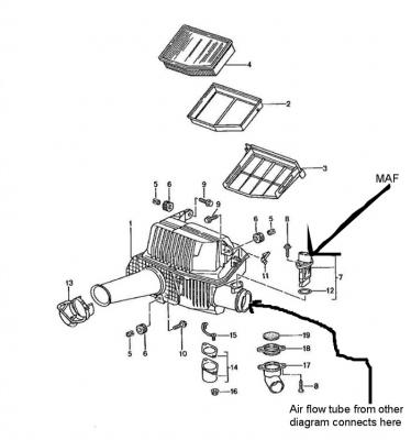

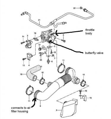

In any case, here are a couple of diagrams which should help orient you (Click on the diagrams to blow them up so that you can see the various parts more clearly):
Part #4 is the air filter cartridge. Make sure all of the clips that hold the air filter housing shut around the air filter cartridge are properly fastened.
Among these parts, part #9 (air sound baffle) may give you some difficulty because there is not much space between it and the underside of the engine compartment perimeter.
Also, if you look at where the arrow points to the butterfly valve, you will see a horizontal "rod" immediately above the arrow. Where that rod connects to the throttle body and pivots, both on the left and on the right, is where you should make sure that you spray plenty of cleaner. That is where it sticks, along with where the whole circumference of the butterfly plate contacts the throttle body.

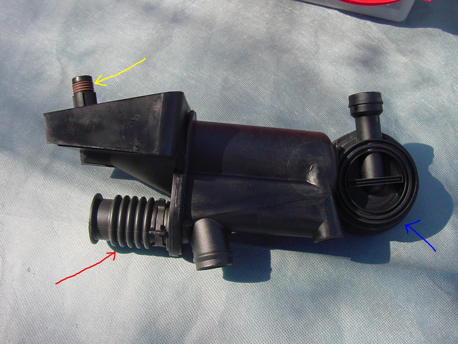

Here is a photo of the AOS with the red arrow pointing to the bellows (again, click on the photos to blow them up):
(The yellow arrow is pointing to the other part which gets pressed in to the engine block with some of that lubricant when you get ready to install that new AOS that you have coming).

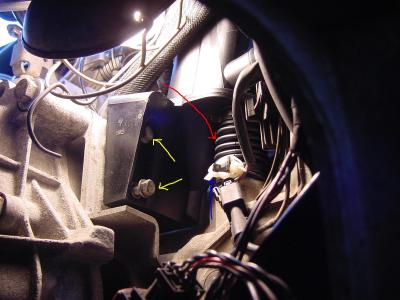

Here is a photo showing the location of the bellows when it is installed on the installed AOS:
This photo is taken with the right rear wheel off, the car up on jackstands, and you are looking up through the wheel well, at about a 45 degree angle, on a diagonal, in a line, say, toward where the steering wheel is inside the car. My drop light is hanging down just above and to the left.
The red arrow points to the bellows.
The yellow arrows point to the the two 10mm bolts that secure the AOS housing to the block (the bottom bolt has not yet been tightened).
The blue arrow points to two heavy zip ties that I used to hold the factory clamp open while I pressed the bottom of the bellows onto the protrusion in the block. I later cut the zip ties to release the clamp in place. This is the reason I recommend those Sears hose clamp pliers, but it can be done this way in a pinch if you have heavy duty zip ties handy.

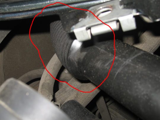

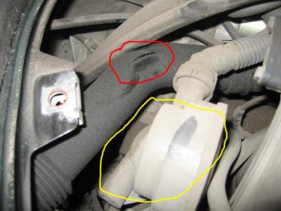

hey maurice, thank you for your quick response. i cleaned the butterfly valve and the all the oil off top of the engine. and it turns out that the color of the part is black to begin with (duh...) and there actually wasn't that much dried oil on it. so i reconnect the trunk back on to throttle body, that's a ***** try to put it back on, and the air filter housing.
then i went to investigate and familiarize myself with the AOS, i think i found the culprit to my problem. the hose next to the top of the AOS has a crack (see picture. the red circle indicates the crack and the yellow is the top of AOS correct?) i don't know what this hose connects to. i tried to follow it but again with my very limited knowledge, i have no idea where it leads to. so, here are more of my stupid questions, is it likely this is the cause for cel P1130, vacuum leak, and the big puff of smike at start up? is it likely that my AOS is still good (i'll still change it out when it comes next week)? lastly, hose this cracked hose, is it safe for me to drive my car, just locally and short distance?
thank you all for the instruction, encouragement and patience. i do feel rejuvenated and definitely have more confident to work on my car more. i can't say enough about this forum. whomever started this needs to get a medal of honor. :thankyou:
You are most welcome, and good work!
What you have circled in yellow is definitely the top of the AOS.
The other tube with the crack outlined in red is, I believe, the oil fill tube. That tube usually comes in three parts, and the part that you highlighted is the middle tube and it usually has a "mesh sock" over it to protect it from chafing. If it is the oil fill tube, that can cause a CEL due to the vacuum leak. See if you can follow the tube towards where it would come through the firewall between the engine and the rear trunk in the vicinity of where the forward face of the coolant tank where it is mounted on the trunk side of the firewall.

The dense foam patch you can look around for at Autozone or at Home Depot. You only need a small rectangle, like 2" by 3" or enough to more than cover the crack and conform to the curvature of the tube. You can temporarily use electrical tape to wrap it on there because it stretches and will allow you to make a tight seal.
As far as driving the car, you were driving it before you discovered this crack, so I imagine you can drive it now with no problems. Some Autozones will also let you borrow their code reader to read and then erase the codes (not in California).
Let us know if your idle and throttle response has improved or changed.
Well done Shihman - from your rather apprehensive start you had the balls to get on with the job, The oil and gunge around your throttle housing confirm the AOS has had its day so get that changed.
Tape the split over for the time being and start up the car - your tickover should now be steady and once you change the AOS no more oil will get to the throttle body so it will be years before the deposits build up again.
Maurice has certainly provided you with excellent advice, schematics and photos - plus the additional support and encouragement - this is what these forums are about, and despite whatever we all like to think we know about the Boxster there is always someone with more experience in a particular area - in short we all seek help or ideas from time to time.
enjoy the car (hope you keep it) and give yourself a big pat on the back for getting stuck in.
