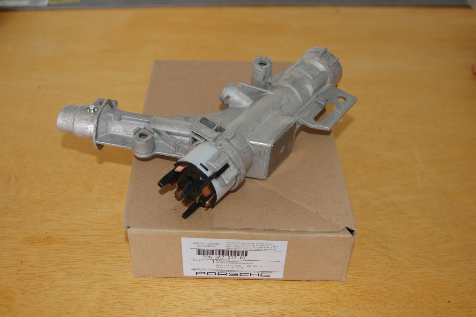

I have my Ignition switch steering lock assembly out of my car ..How do I remove the key assembly from it to put it in my new assembly.I bought a starter switch originally ,because the car wouldn't shut off when I drove home from work.I changed the switch,and found out the steering lock assembly was the prob.It is on a 99 boxter 986.Can some one please give me som feed back..I have had this car since jan.And I have probably driven it 6 times,because something is always breaking..lol..I am just ready to do more mods,but I can't crank my car :lol: ...thank you for any feed back you can give me..

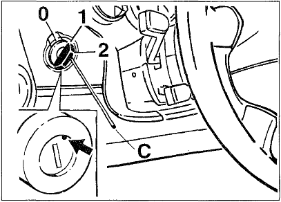

Removal
1. Disconnect battery ground cable.
2. Pull cover (collar) off the steering lock.
3. Insert ignition key and turn to position 1 (ignition on).
Insert a steel wire C with a diameter of approx. 1.3 mm (max. 1.5 mm 0) into the bore next to the ignition key (arrow) as far as it will go. Pull the lock barrel with induction coil out of the steering lock housing.
Note: Inserting the steel wire C unlocks the lock barrel in the steering lock housing.
4. Carefully unlock and separate the plug connection on the lock barrel (at the induction coil for the immobilizer).

Thanks!!changing the ignition assembly was a piece of cake..The info on changing the key lock barrel was very helpful..I had everything else figured out ..that was my only obstacle that I couldn't figure out by just looking at it.Thanks again Loren :renntech:
