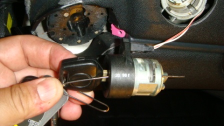

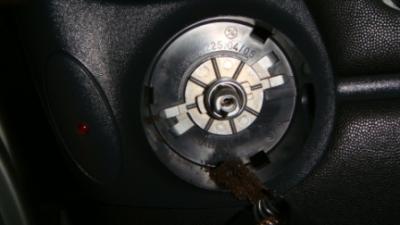

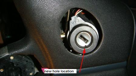

It took me a while to get the key cylinder out. You have to get your "paperclip" back about 2 inches. Also when you remove the cylinder keep the paper clip in and do not remove it or you have to redo it when you put it back in.
Picture with clip in out ring hole. I had a key witout the key head. You can probably do it with a normal key but the black head would get in the way a little.
Remove entire cylinder, just by pulling out when released.

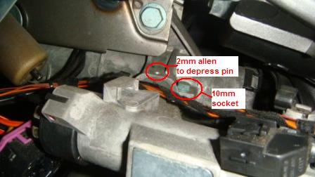

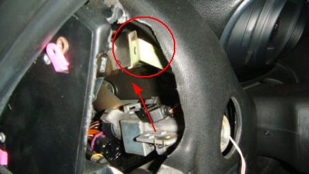

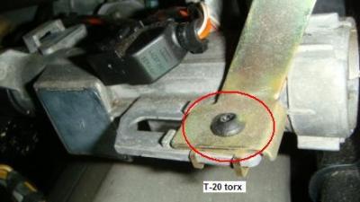

Im not a big fan of leaving a bolt out as he does in step #10. It is really the only bolt in the housing. The pin does hold it as he describes but I still perfer to put everything back.
You can actually get to the nut area from underneath the dash. Its a little hard to do if you by yourself but I stuck a socket wrench on the top of the bolt while I threaded the nut on lightly from below.
Then you can the use the socket wrench from the top when the nut gets a little tight.

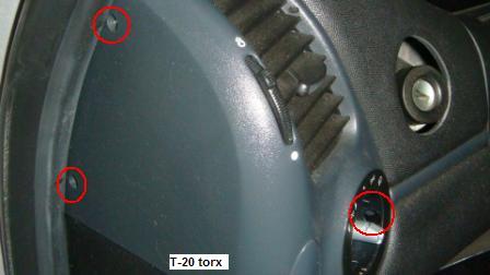

3) Remove the left hand vent. There’s a nice writeup on this already; so I won’t repeat all of that here. http://www.renntech.org/forums/index.php?a...ost&id=6617
Here are the basic steps from the link:
Insert narrow screwdriver into hole under the switch.
Turn blade up, not flat.

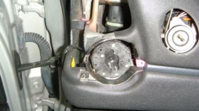

Here is what it looks like from the backside.
Remove 3 screws from the above areas.

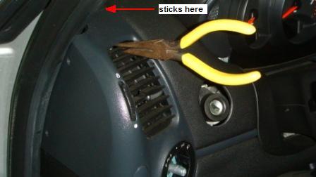

Give a gentle pull from the top. mine was a little stuck.
Disconnect plug connection, I had to pry with a screwdriver as my wires were not long enough to let my hands get behind the vent.
keep this in mind as we get to the end of this DYI.

1) Reach to the back and disconnect the wiring harness from the ignition switch. It just goes straight off the back; no special clips there and don’t twist it.

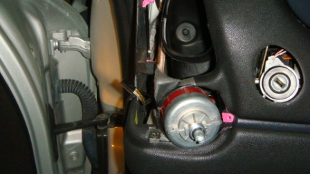

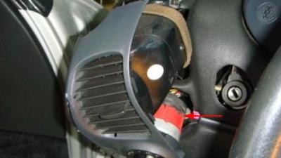

Looking through the vent hole
A little closer look.

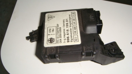

2) Remove the immobilizer. It’s the black box on top of the steering lock housing. Unclip the little wiring harness on the front right. This one has a little catch on it so don’t just pull it out. There is a little plastic Phillips head near the key that you give a quarter-turn. Mine had ‘wings’ on the Phillips head that I could turn by hand. Once you’ve turned this, slide the immobilizer straight toward you along the top of the steering lock housing. That will free it up to remove.
Here is what it looks like removed.

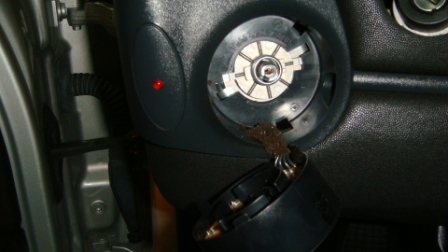

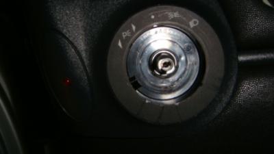

3) Remove the key cylinder. Around the key hole is a silver beauty ring. Around the edge of that ring is a small hole. Make sure the hole is near the 7 o’clock position instead of near 1 o’clock. Mine had turned 180 degrees at some point and made this cylinder removal impossible until I figured that out. Insert your valet key (it’s just easier, but your regular remote key will work) and turn to position 1. Now stick a straightened paper clip (I used one of the larger, sturdier clips instead of a standard one) in as far as it will go. The cylinder should virtually fall out if you’ve done this right. If you’re having to tug on the key to pull it, try again. Carefully disconnect the electrical clip from the key cylinder. Leave both the key and clip in the cylinder and set the thing aside.
My switch was in the 1 o'clock position when I started but went back in at 7 o'clock position.???

3) Replace the mounting screw near the key hole. By the way, I never replaced the 10mm bolt at the steering column. I couldn’t figure out how to restart the nut on the bolt, plus with that spring pin engaged, I can’t see how the housing could ever come out under normal use.
