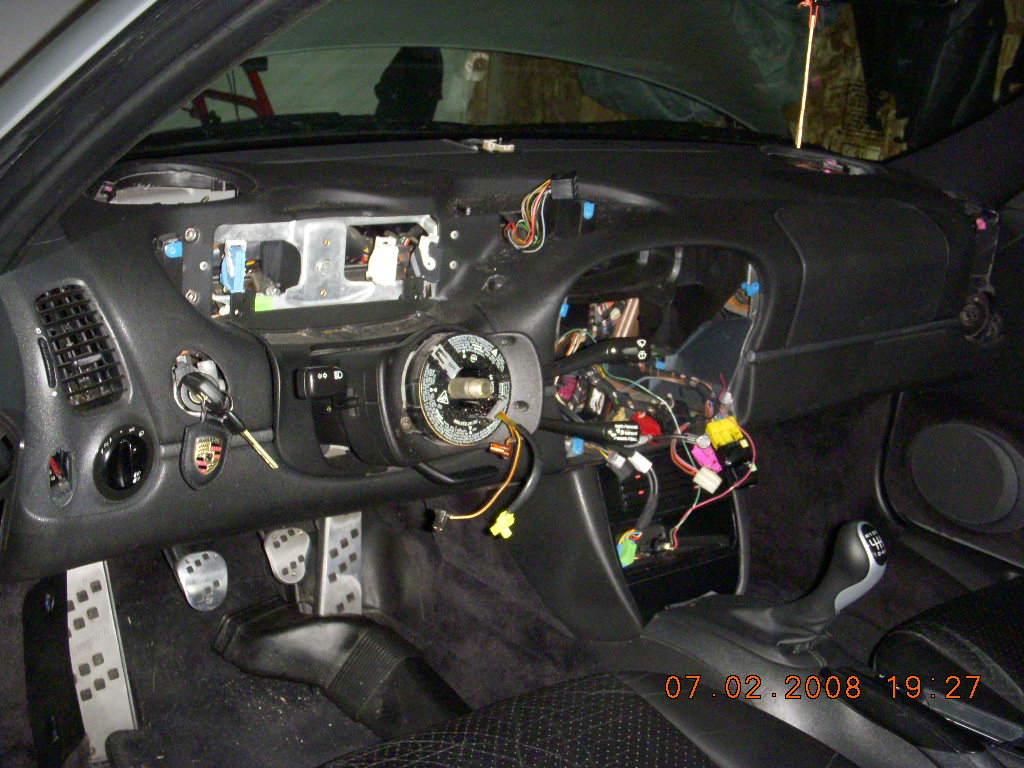

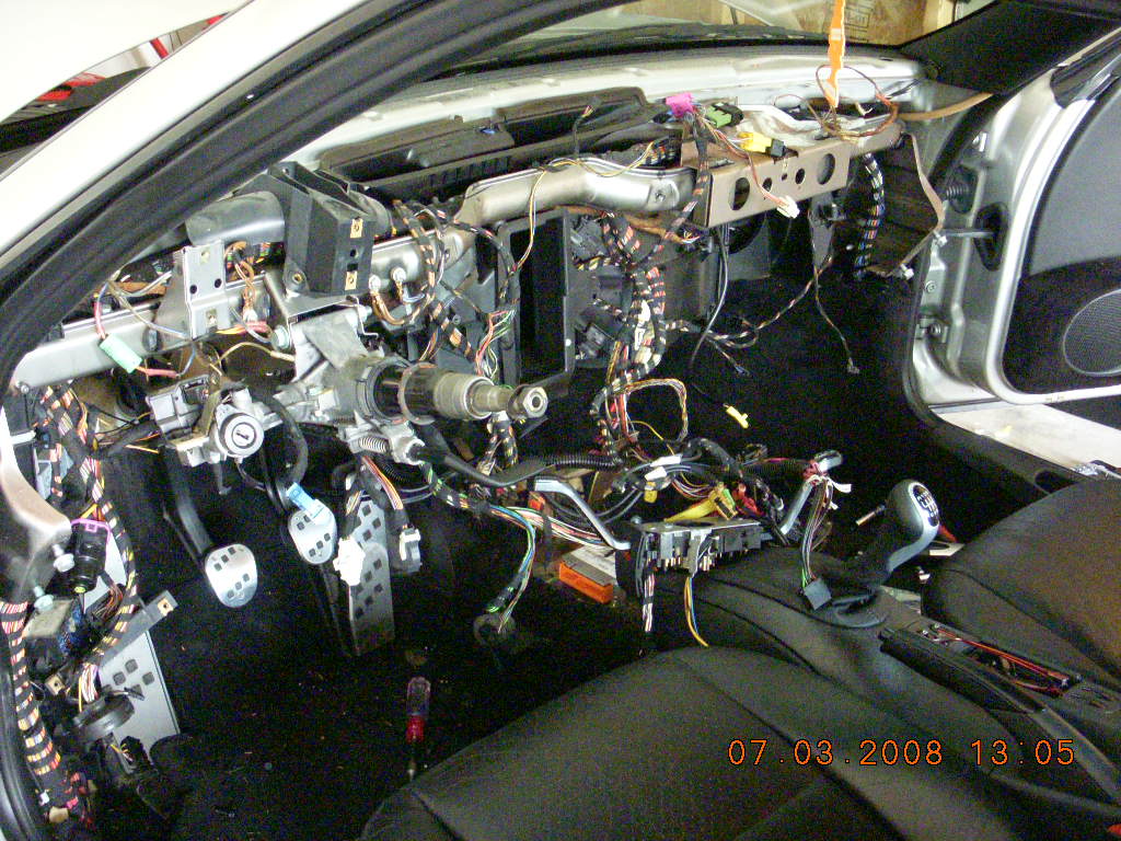

I solve this thing almost my self. The plan was to buy the evap at pelicanparts. Dismount all you see in this pics with the workshop manual took 6 hrs, very easy. except the evap housing in which the mechanic dismounted and mounted. I replaced my self the expansion valve and dryer. Then I mount the rest back in like in 5 hrs @ home. And return for air recharge.

-replace the evap from housing and put it back $400

No, I just unmount the interior parts at home, the mechanic couldn't work at my home so I took it to his garage in the conditions you see in the first picture. The mechanic just replace the evap from the housing. For me was to much complex to work in the evap housing area. Then the dumb mechanic didn't let me mount everything on his garage for insurance purpose. Then I towed back home to finish it. Just take this as a experience.

Replacing the unit wholesale essentially requires taking the dash off, and removing the wiper assembly and battery. It is held on by three threaded posts that pass through the firewall, plus one place on the cockpit side. Takes patience, but getting the dash off is not that bad IMO.
