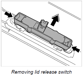

1. Carefully press fastening ribs of scuff plate -arrows- outward with a small screwdriver and unclip switch for lid release.
Install is the reverse.
1. Clip in switch for lid release with the locking tabs in the fastening ribs of the scuff plate -arrows- so that they are felt to engage.

In the diagram, the switch looks upside down. And where are the two Allen screws and plugs? Thanks. Oh, and I broke the switch lever exactly as you did!

The picture is weird. You can find the two plugs
real easy with your hand. They are down
next to the seat. You will need to move the seat
forward or back to get at the #10 screws.

I have just done the trunk release exchange. Taking the door sill out was easy thanks to the hints described here. But removing the switch module from the sill was real challenge. Forget the picture posted by Loren. I have tried everything and at the end I found the trick. Lay the sill on the table bottom up. Then you need a very narrow screwdriver 2 mm and you need to push it between the hold tabs of the module. There is s little space there. Just push it straight down and it unclips. There are four of tabs, two on each side. Instalation is very easy, just push the new module to the place until it clicks.

I agree - the diagram at the top is completely wrong! Or at least it was for me.
