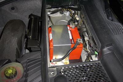

I am considering a PC1220 from Odyssey. I talked to them and that is the one they recommend for my 2002 911 Targa (See http://www.odysseybatteries.com/batteries.htm for specs) It has 680 CCA and 70 WH for total capacity. The higher CCA is a real benefit if the car is not driven every day. My problem is I only put a couple of thousand miles on the car every year and the batteries keep dying. The Odyssey is designed for vintage use and has almost no discharge if disconnected (which I plan to do with a kill switch).
Share this post
$320??? :eek: 680 CCA is not high though. A regular size 48 has 700 CCA.
Share this post
That is a lot of money for a simple car battery. You would be well away to buy a regular battery and use a quality maintainer.
