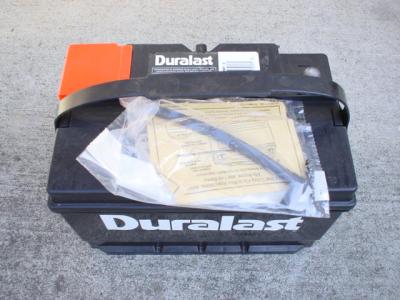

I got the Autozone Duralast and the guy said it didn't have a vent tube - I asked him to check again or look at another battery - Oh, he says... I guess it does have one. This is what I bought and installed today...
Loren,
Funny timing that your battery died. That looks like the battery I got and the model numbers are the same. (48-DL) Mine did not come with the orange cap over the positive terminal nor did it come with a vent tube. It looks like you plugged the vent tube int the center of the battery. Is the vent home on your battery an oval shaped end? If so, I have that too and didn't realize it was a vent hole. Correct?

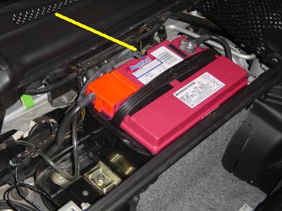

You have a vented AutoZone battery. The vent is oval - the first yellow line. The yellow lines are to the vent in the middle rear, unlike the side vent on the Moll battery. The second yellow line is to the black rubber vent tube that comes in the plastic bag, and there is also an adapter in the bag for the clear plastic oem vent tube.
On your battery, someone removed the orange cap over the positive terminal, and the plastic bag with the vent tube/adapter/instructions inside the bag, as the bag should have been glued to the top of the battery.
Yes, the vent is the oval opening in your pic.
The supplied tubing is larger than ours but it is not a problem as the small plastic coupler is large on one end (for the new supplied tubing) and small on the other end (for our original tubing). I did have to cut the original battery fitting off the the original tubing as it seemed glued on. The clear plastic is original and the black is supplied with the battery.

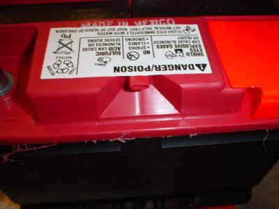

For Kevin, I took a picture of the oval vent. One of the batteries on the shelf did not have the plastic bag with the vent tube glued to the top of the battery. The rest of them did.

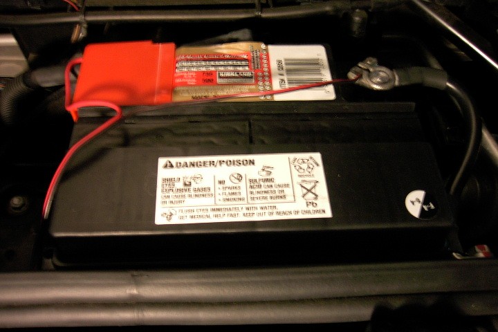

Since everyone is taking pictures here is the Costco size 47. Looks suspiciously like the others, same vent tube, same red positive protector.
