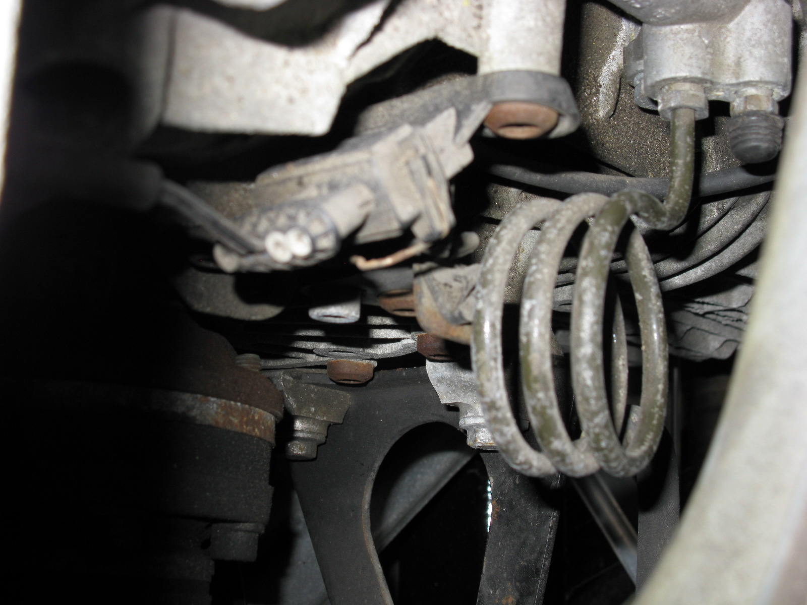

The Boxster clutch slave cylinder and bleed valve are on the left side (driver's side on U.S. cars), high above and forward of the inboard side of the left rear half-shaft. You will see a sort of "wound-up coil" of brake fluid line to the left of it, leading close to the location of the bleed nipple. Follow that coil to the clutch slave cylinder. For another reference point, you can see the black cutout bracket which is the transmission support bracket. One side is bolted to the side of the transmission, the other side rests on top of one of the two transmission mounts.
Here is a photo of that coiled brake fluid line leading to the clutch slave cylinder at the top right corner of the photo. The bleed nipple is directly to the right, under that little protective rubber dust cap (you can see the inboard side of the left rear halfshaft at the bottom left of the photo):
post-6627-0-42269400-1293388902_thumb.jp
