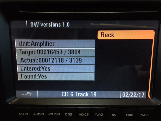

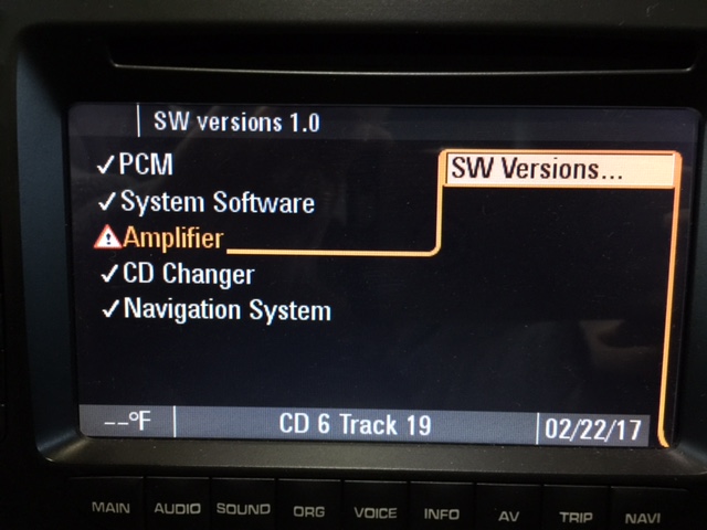

Hi Richard,
I checked the version of the Amplifier software of and found an exclamation mark next to the Amplifier (see images).  Should I have proceed the normal update or you mention there is an method to modify the update CD to bypass the Amp?  The version number is way lower than your suggested 0017500, but this is a Cayenne, not a 997.  Thanks.
Edited by gchu
There shouldn't be any problem updating your amp. The warning triangle might be caused by a fault, but I have seen lots of occasions where there are warning triangles and there are no operational problems with the system.  Sometimes they clear after updates, and sometimes by clearing the fault memory with a PIWIS.
The Update DVD Kit arrived today.  Followed the TSB instruction and everything went smoothly well.  After that, the exclamation mark of the Amplifier is gone.  Tested everything and found no other issue.  Thank you for everyone that helped me on this.  My map has been updated from 2004 to 2015.
