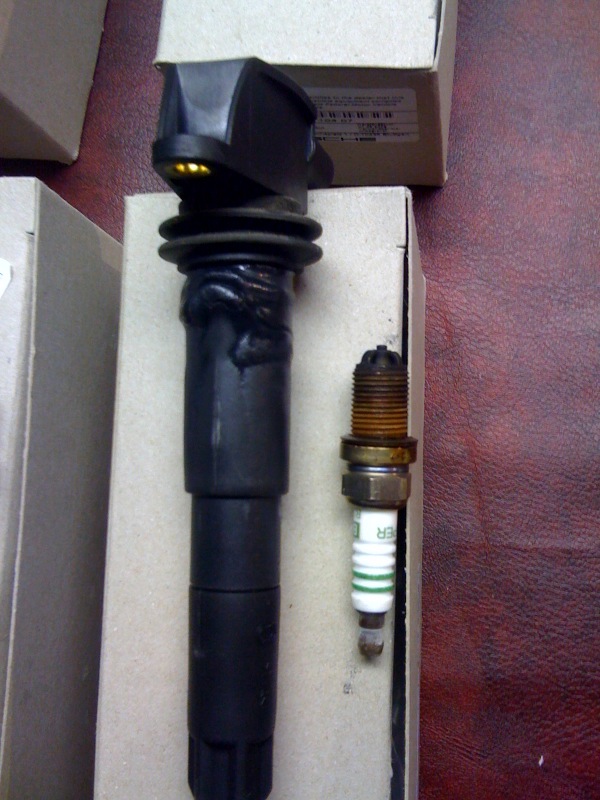

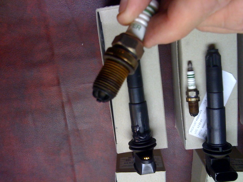

To briefly summarize... last week my 04 CS started running rough on the highway, limped home, CEL came on the last mile or so and there is sat until tonight...The folks on rennlist helped me diagnose this as the very common bad coil issue. I bought new plugs and the -07 OEM ignition coils.
So me and my mechanic friend dove into the deep end tonight. It only took a couple of hours and one trip to AutoZone to get the Coils and plugs replaced. All 8 coils were cracked and one of them had basically MELTED!!!! After everything was replaced and put back together we fired her up and were, needless to say, disappointed. The P!g is still running and idling rough, sounds like it's misfiring and barely had enough power to move up the driveway. The CEL is still on but I'm guessing that it will stay that way till it's reset or clears up per ODBII. As far as the current trouble (post replacement) I'm hoping that the electronics told the motor to shut down the cylinder(s) with the melted and badly cracked coils to keep from causing further damage, and doesn't "know" that it's ok to fire them up again but I have no idea what to do next. Is there a way to "reset" the computer without hauling it down to a dealership? Any tricks to get my baby running again. BTW my mechanic buddy said in all his years he's NEVER seen a coil melt like this one. Could it have done some kind of damage I'm not aware of? I sure hope not.
here are a few pics for your viewing pleasure. Any help, ideas, or suggestions would be greatly appreciated

You did install Porsche parts right? Give us the part numbers and we'll double check them.
Check it with a fault code scanner to see which cylinders are misfiring. Could be cracked coils (overtightened) or loose connections or wrong spark plugs.

The ignition coils were part # 948.602.104.07 (BERU) and the plugs were Bosch Super 7413. Both were ordered as OEM parts. They looked exactly like what I removed, minus the cracks and gunk. It just runs like it's still not firing all cylinders. That's why I was hoping someone knew of a way to reset it's brain, and that maybe it was still in some kind of "limp" mode because of the horribly melted coil and the other 7 that were cracked.
Coils are correct - so check that they are not cracked and that the electrical connector is firmly snapped in place.
