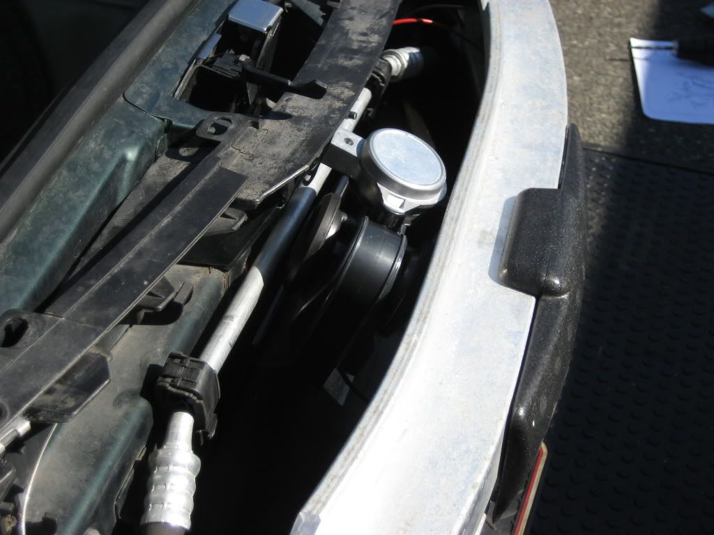

I also added the Italian Air horns as mentioned on other posts by Loren and installed them above the center radiator. Here is a photo of the Airhorns after installation.

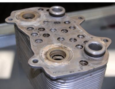

Do these mounts look the same to anyone else?
..they fit without any additional modifications..
No modifications?
How do you seal the oil passages without modifications?
What do you do with that tube that does not stick out of the top of the 1997 (986) heat exchanger?

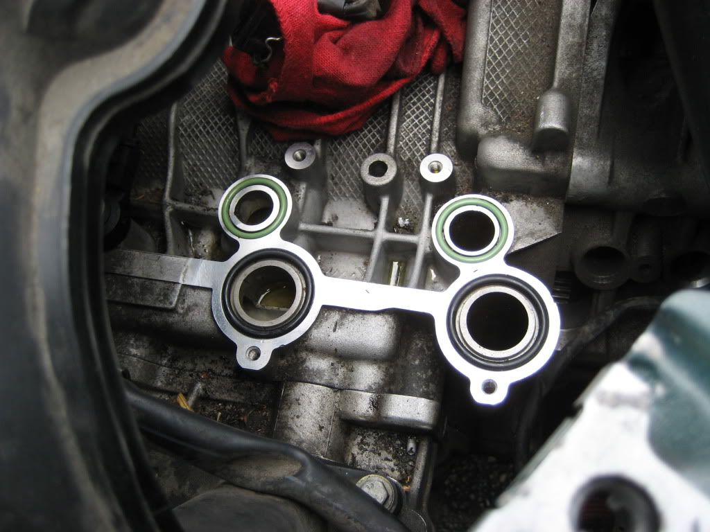

Very simple: That is the very early 2.5L oil cooler, that uses an adaptor plate (attached to the cooler in the photo) can be removed and moved over to the newer cooler, which is flat on the bottom, with openings for the oil and coolant. These adaptor plates were only used on the very earliest 2.5L motors. The later cooler will still fit, and this is exactly why most dealers seem to sell you more o-rings than you need to put it on most M96/97 cases; the extras are incase you have this adaptor plate and need to transfer it over, otherwise you only need four o-ring, two each in two sizes. The “how to” section on replacing the oil cooler on a M96 with an adaptor plate is even covered in the Bentley manual, shows the adaptor, and where the extra o-rings go..............
The very early 2.5L cars did not have a ventline running from the top of the oil cooler to the rear boot surge tanks (added early to mid 97 after problems with air becoming trapped in the cooler, which is the highest point of the cooling system, reducing its effectiveness). All replacement tanks have a fitting for this line, as do many cars built in 97. On a very early car, without the connection on the tank (which would be very rare as the tank without the fitting only exsisted for a very short time), you can simply plug the line on the cooler; but a far better move would be to update the surge tank to the new design, if one is not already in the car, to prevent air entrainment. To my knowledge, the tanks without the line for the oil cooler are no longer available.
And just a by-the-by, I've only ever seen two Boxsters with the adaptor plate, both 2.5L 97’s, which is still listed in the PET, but unnecessary on 99.9% of the Boxsters ever built......

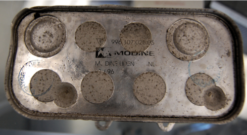

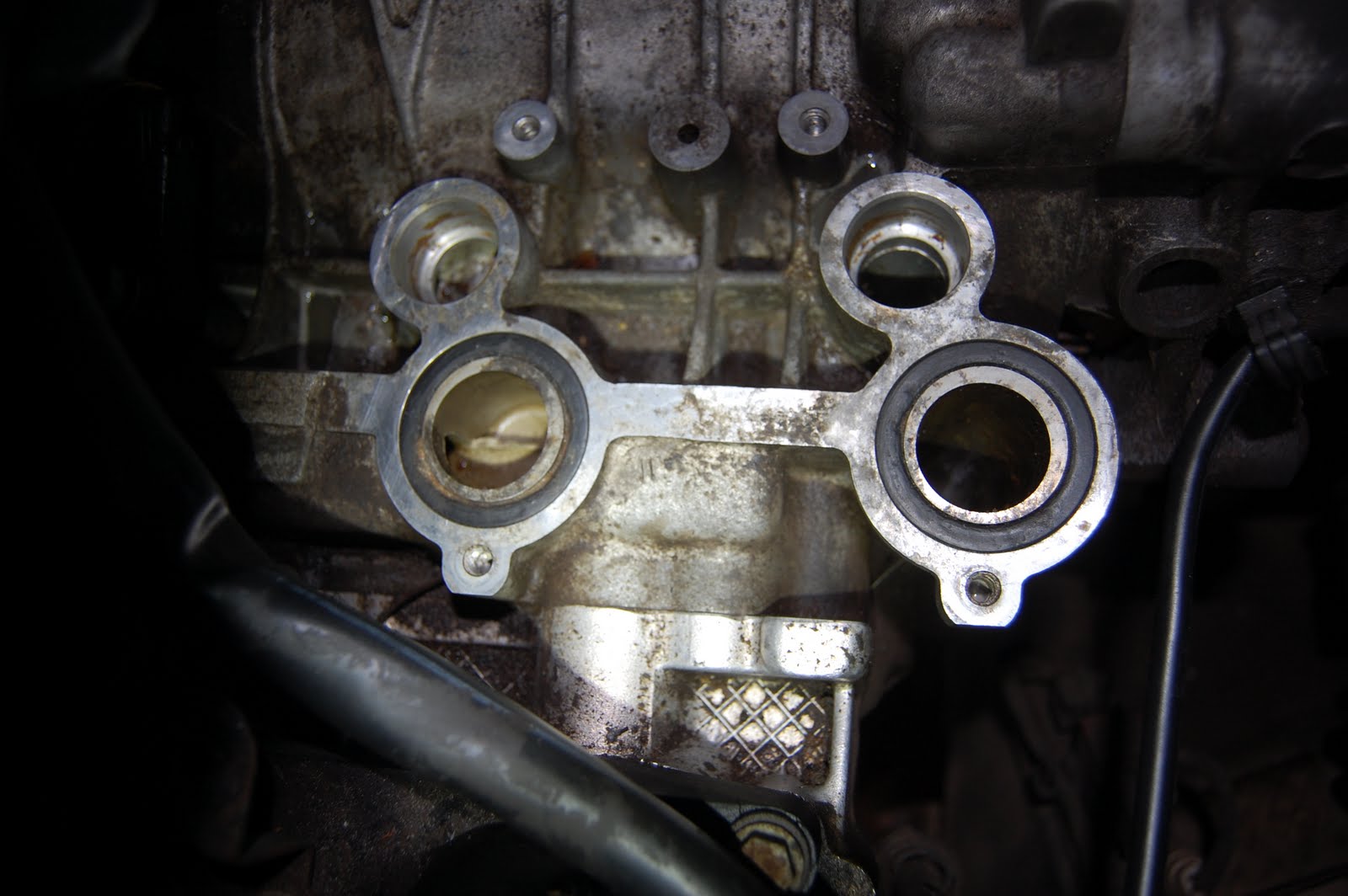

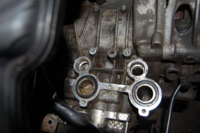

This is the very early 2.5L oil cooler #996.107.025.05, that does not have an adaptor plate.

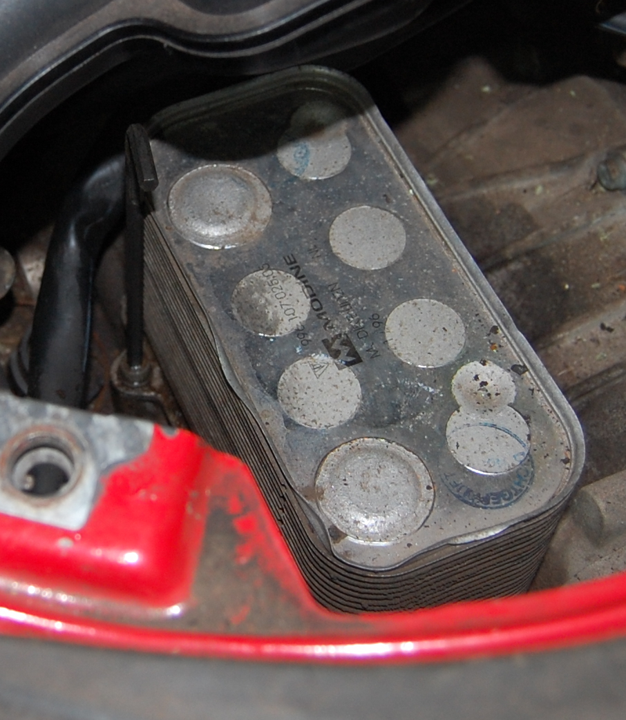

You can see in this picture the allen wrench removing one of the screws holding the heat exchanger onto the engine.
Here you can see the four short bolts removed just before the part is lifted from the block.

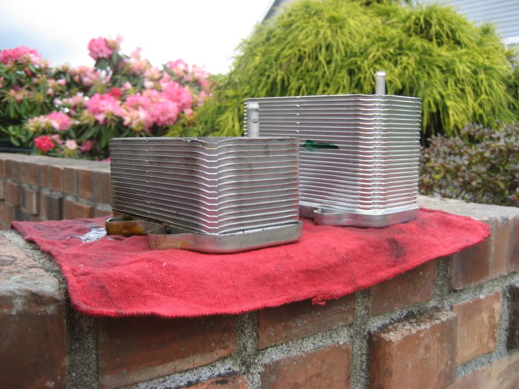

Here is the original heat exchanger removed. No plate, no vent. It bolts right to the block. This heat exchanger is much bigger than the new part and weighs a good deal more. I do not think it is made out of the same material. This one has probably provided good service for 14 years before leaking. These male oil risers is why you can remove the heat exchanger, and let the coolant run out without getting it in the oil. You can probably do the same thing with the new cooler if you unhook the vent, and let the coolant run down before cracking the exchanger.

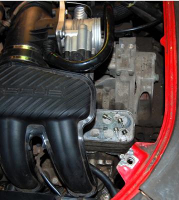

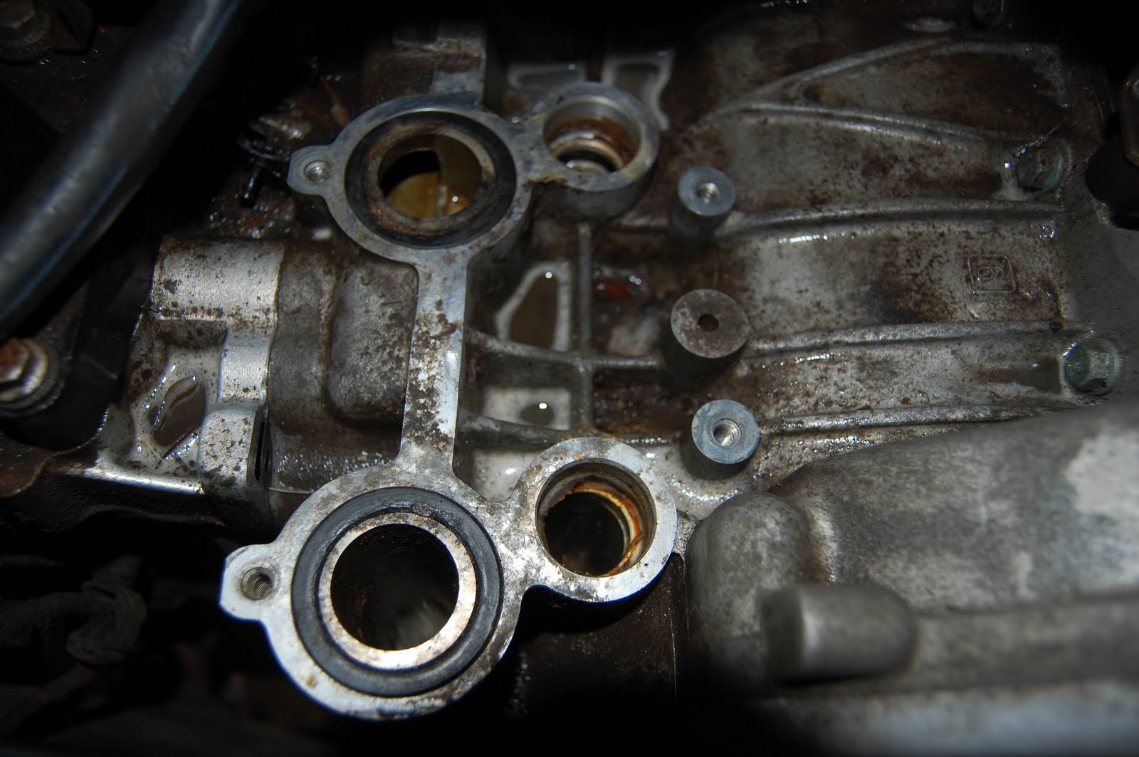

This is what the engine looks like when the oil cooler is removed. Two seals in the block and two seals on the cooler. You can see how the part fits, held by four allen screws.
This is the view preferred by the previous poster.
This is the view posted by the previous poster of the revised block. His block has four seals, and his oil cooler has none. The new part does not fit on the early block.
Edited by Sumflow
Which is why when using the newer cooler one will need the adapter plate, #35 and P/N 99610712900 MSRP $157.28 in the picture below.
