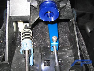

The sloppy feeling may not be from the shifter itself, but from the shift links. The OEM shift links (part that snaps onto the shifter itself) are made of plastic and tend to wear out. I did the B&M short shifter, but also replaced the shift link with an Agency Power one. Even if the shifter is replaced if the shift link is worn it will still feel sloppy.
This may open an another discussion.
Checked out the Agency power site and found the shift link as shown on the picture on the right side.
So you say that this will definately improve the sloppy feeling?
My experience is that the shift linkage made a big difference. Mine was very worn so there was a lot of slop in it. Not a cheap part, but it is made out of aluminum and won't wear like the OEM plastic piece.
