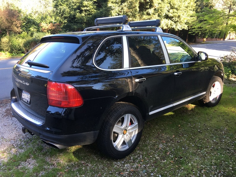

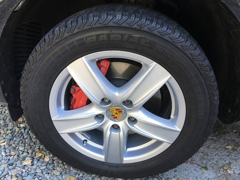

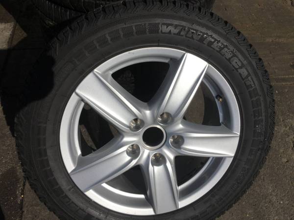

I want to buy a used set of Cayenne 2011-2013 18" rims with winter tires for my 05 Cayenne Turbo to go skiing. Is this going fit or cause any problems?
Too bad you're not closer to me.. I have a nice set of '06 Sport-Design 19" rims with Pirelli Scorpion snows that I'd like to sell.. they would go right on your Cayenne, and look better then the one above to boot..
BTW - I don't believe 18" will clear the Turbo brakes. 19" will.
Edited by deilenberger
OK, I went to look at the wheels, they fit just fine and clear the brakes. Offsets look about the same as the current rims, although the 18" rims looks far too small for the car after running around on 20"s. I have no idea why Porsche says they don't fit the earlier cars.
Edited by SpawnyWhippet
