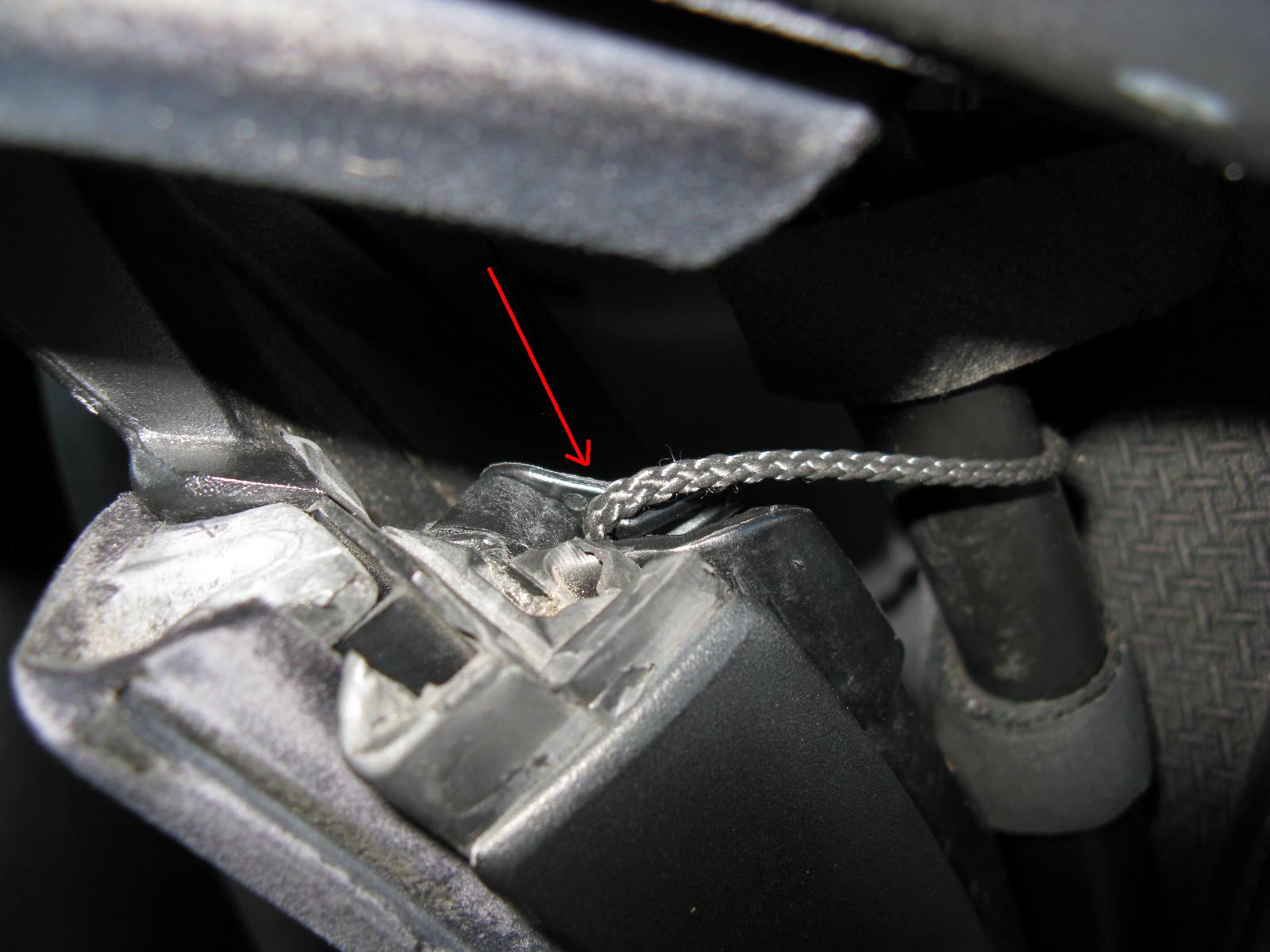

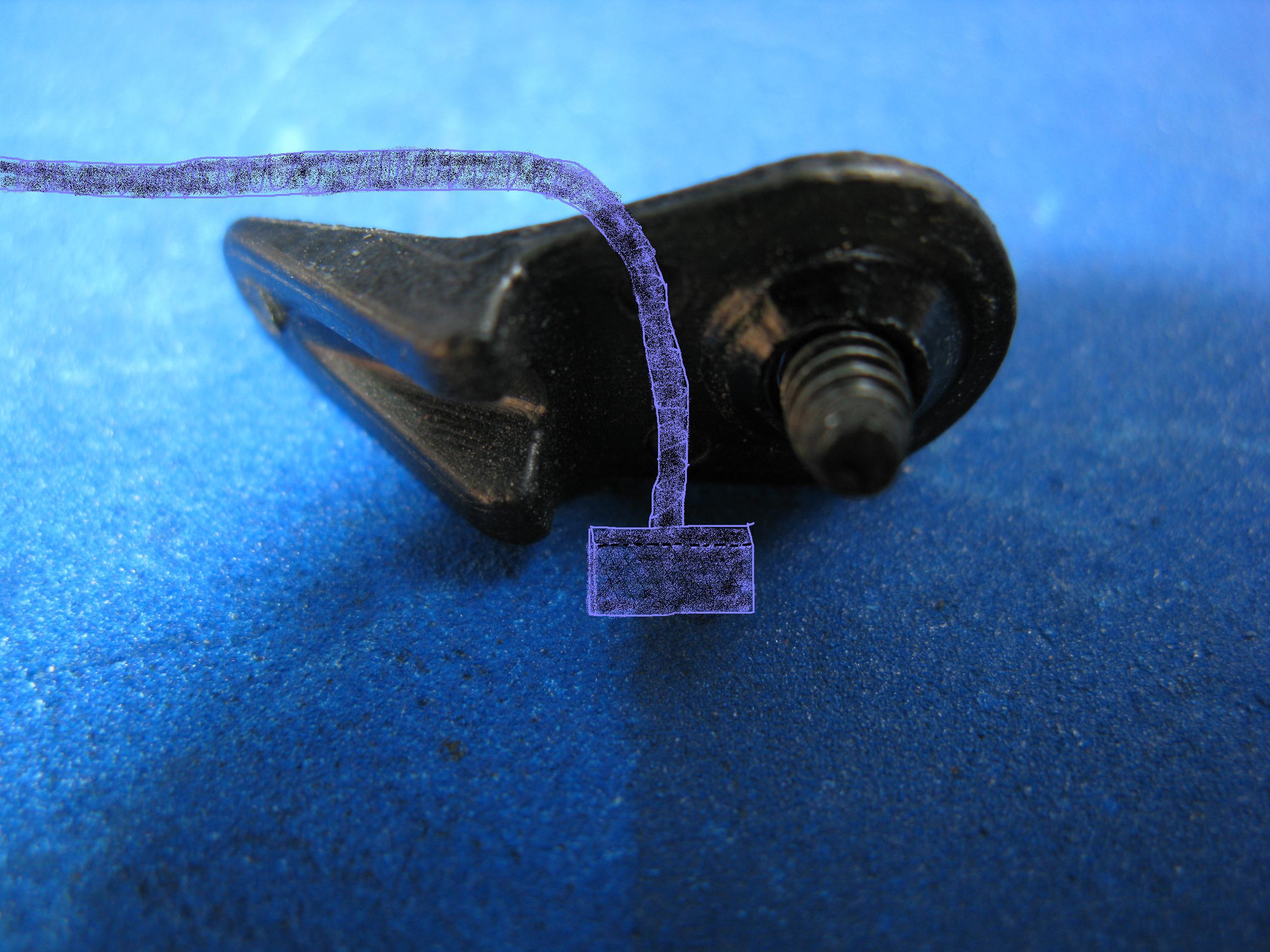

PE:
Here are a couple of photos of what the attachment is supposed to look like and how it's routed, (including one where I drew in the shoestring and its end):

Also, don't ignore the fact that the elastic (in the middle part of this looped string, under the canvas) is there to maintain tension of the tension cables and to place a fold in the convertible top as it moves through its cycle. Be careful that the tension that occurs while the top is moving does not rip apart the looped strings or cause other damage. In other words, it may be a good idea to insert an elastic band section to sort of mimic the action of the original.
