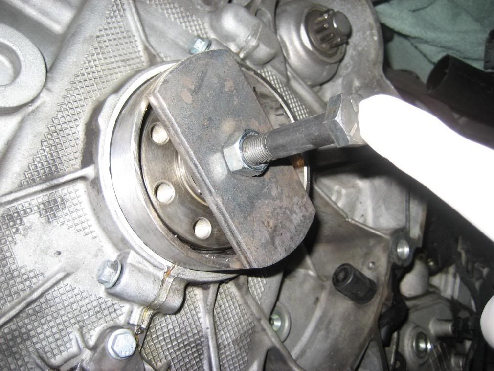

Also, I've seen various solutions for rear main seal replacement "special tools." Anybody got ideas that are easier than constructing the "Lowe's conduit pipe" version, (which is a great idea, but I don't have a router or the other woodworking tools to do it)?

I have one. I had it made. I also have a short 10mm triple square you can use. The Porsche Tool however, determines the tolerance in the opening to help see if a new RMS will keep. My RMS wasn't leaking bad so I figured it wasn't to far out of center (eccentric) and it wasn't going to be an issue for me. Worked for me.
Let me know.
Edited by kbrandsma

Be careful installing your new RMS: as we pushed it it, resistance around the flange caused the thin plastic to curl up and fold in on itself. Not good. Thank God my dad saw it, because we'd have been back under there in a few days wondering why my oil leak was much, much worse. Unfortunately, we had to put a hole in the new seal in order to get it out, and there was just no way to satisfactorily fix the fold in the seal without taking it out.
The good news is that the fine people at Pelican Parts have probably got plenty of rear main seals to sell me. I'm seriously considering getting 2, in case we screw up again.
