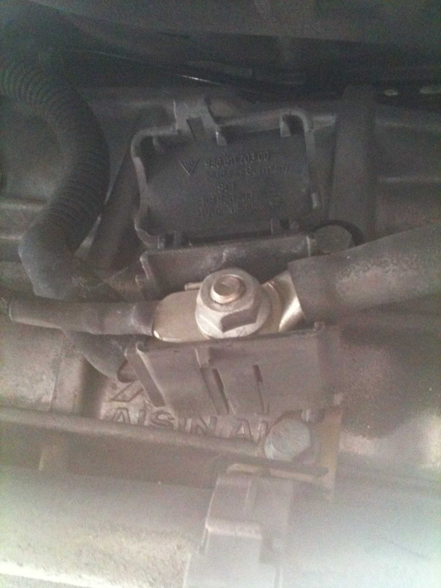

I was able to get under the car and I believe that I found what you said (mounted to the transmission on the passenger side) but appear to be very clean. I'm trying to upload the picture but I can't. Could you send me your email so I can send you the pictures. I can't find an upload button, it is asking me for a URL! I don't know how to do this...

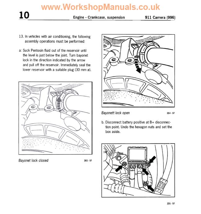

post-55108-0-98259400-1292111366_thumb.jI think I got it.
post-55108-0-49012100-1292111106_thumb.j

The little box should be located on the passenger side of the transmission. It is a plastic black box (maybe 2 inches long) that you have to open to see the cables, as on picture.
My issue is that apparently my charging system is not working properly. I was hoping that it was just a manner of cleaning the connections. But apparently it is more than that since it was fairly clean and I still have the same problem.
As for location, you have to remove the first under carriage cover (over the rear axle) and you should be able to see mounted to the passenger side of the transmission. This could solve your problem…but did not solve mine.
My problem is that my battery is not getting charged fast enough after starting the car…therefore, if my car does not rest (or run for a while) before stopping it will not start again. The battery does not have enough juice to start. Battery was replaced but it is not the problem.
