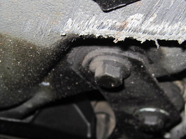

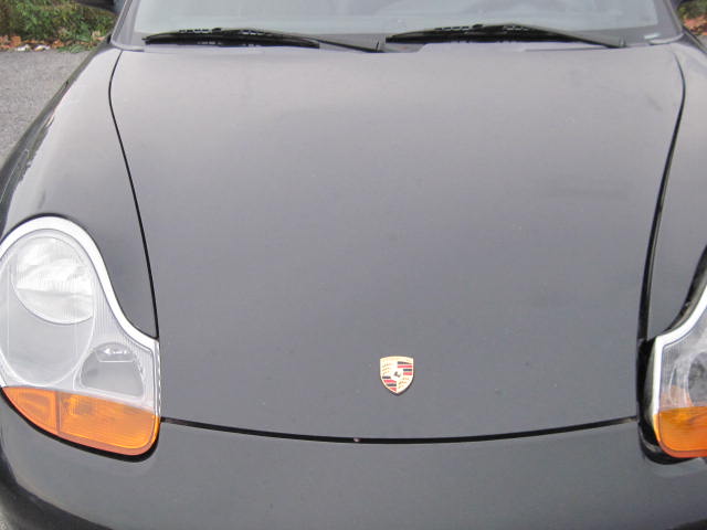

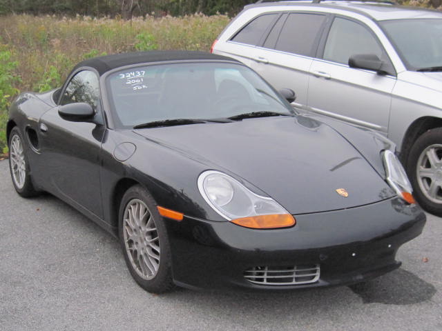

I am considering buying a damaged 01 boxster. Damaged is the only way I may afford one. It was hit in the front driver’s side but I think it looks worse than it is. I am considering buying this as a DIY driveway repair and was looking for any comments and suggestions from members, including what you think the car may be worth, has 50K on the clock (assuming all else is ok, there is a small tear in the rear top vision panel). see atached photos. I have done things like this in the past on American cars from the ’70. Thanks

From your pictures, it looks like you're looking at several thousand dollars in parts even if you go through Sunset for a great deal and buy some parts used. Front bumper cover, radiator, fender, mounting parts and who knows what else. Porsche parts can be expensive, even at a discount. Even if you restore it perfectly, the engine could crap out at any time depending on how the car was maintained, so definitely get a pre-purchase inspection on the mechanicals before you buy. Unless you're getting the car for next to nothing, you might want to shop around for a better car that doesn't need much work. Heck, if you're getting the car for next to nothing, grab it, part it out to some of the spec Boxster racers, and use the proceeds to buy something in one piece that runs.
It looks pretty good..(You might have to check to see if the frame is bent.. it could be a write-off.). If it is secure it really doesnt look that bad.. do not purchase parts from the dealer unless you have to.. It will be costly because the part might have to be brought in from the germany plant.. junk yards on occasion do get porsches.. you will have to get a repair manual.. It's a car and DIY should be no probs, for alignment of headlights follow the manual and alignment of the front wheels should get done by a professional.
Thanks for the replies. If I wind up with this car my plan was to get used parts (already have some price info from a breaker in CA, but no shipping cost yet) bolt it together then have a body shop check the alignment points and adjust as needed. I would then remove the fender and bumper cover again and send them out to get painted (unless the used parts match, I had that happen one time before with a door on a ford!). Any paint required under the exterior skin I will do myself, I have painted a few cars before but don’t have a decent place to do something like that at the moment. To help speed up finical recovery from this project, I may skip repairing the AC until latter; it’s a soft top after all. Does anyone know where to get a shop manual without spending thousands?

From a quick look at your photos it looks like the front tub may have been pushed toward the passengers side. If this is the case, you'll need to have the "frame" pulled back into shape and this requires a specialized jig to bring everything back into spec. These jigs, Celetteis is the maker most Porsche specialty shops use, are $$$ to get access to unless you know someone with one (and they owe you a favor).
