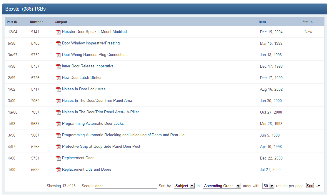

Quite a few TSBs relating to Boxster door problems - these are available to our Contributing Members.

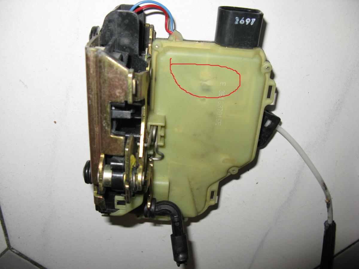

The heat affecting the operation of the door lock may be an indication of a failure of some of the solder connections inside the door lock assembly.
IIRC, there are five solder connections which are located on the circuit board roughly in the area indicated under the red circle I have drawn on this photograph:
post-6627-0-16598900-1375539494_thumb.jp
When you take the assembly apart, you will find little solder "cones" on the circuit board. Inside of each cone is the termination of an electrical wire. You have to look at the "cone" solder connection with a magnifying glass to detect the minute cracks in that solder joint. If you reflow the solder connections at each of those "cones", it will eliminate the intermittent nature of the connection. The cracks are so small that when the car is parked with the door in the sun it will result in a change in the connection/disconnection of the wire to the circuit board.
I plan on taking apart another one of these assemblies and will post photos of the inside circuit board, showing the cones and their cracks.
