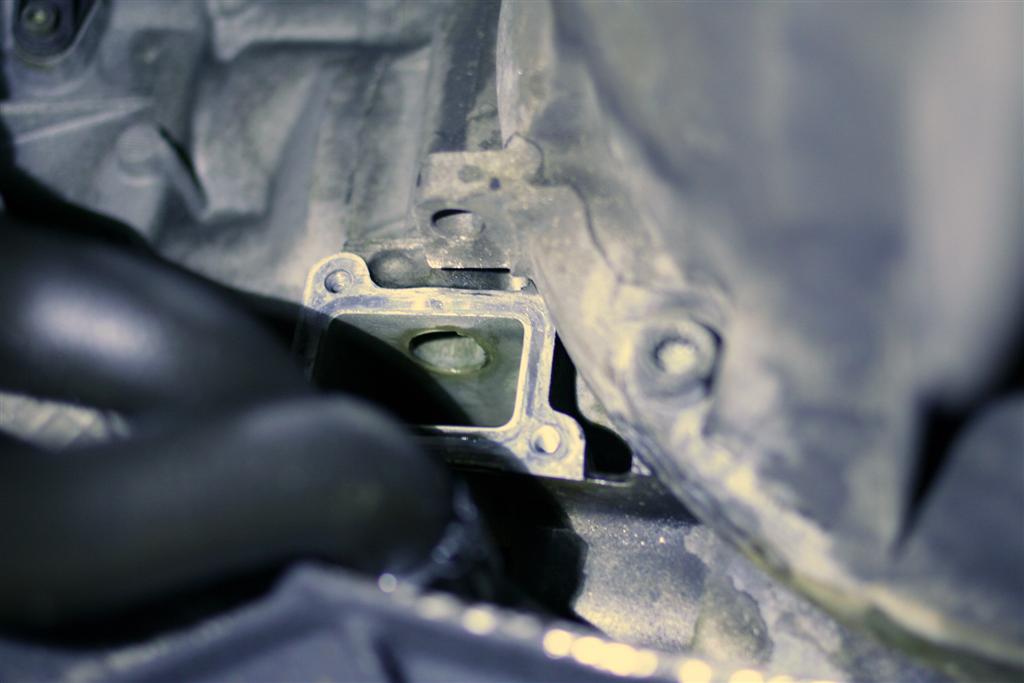

So I have this coolant leak around a metal plate on the engine block close to where the transmission meets the engine
Pic of the plate =>
post-5282-0-26113800-1299133413_thumb.jp
I removed the plate and about 1.2 gallon of coolant gushed out :eek:. I caught almost all of it.

Now I'm left with TWO PROBLEMS:
1) Per the Porsche catalogue, there is a gasket between the plate and the engine block but I don't have this gasket at all and my engine is stock.

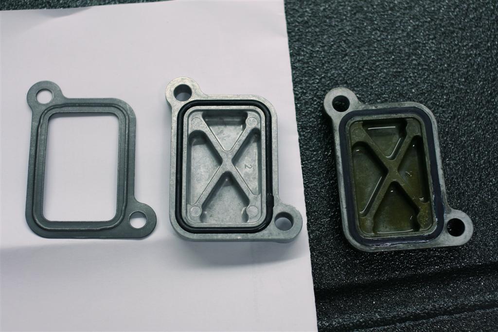

Left to right, new gasket, new plate, old plate. So should I add this new gasket in between or just replace the old plate with the new one? The old one worked for 6yrs afterall =>

To your issue number 1 - Maybe that is why it started leaking (no gasket)? I would put the gasket in.

Thanks for the reply. No, the plate already has a rubber gasket around it. My engine is stock and the plate worked for 8yrs and I'm hesitant to have double gasket.
Make sure the mating surface on the engine is perfectly clean and no scratches or corrosion is present and reinstall without the gasket. The O ring embedded in the cover should provide all the sealing you need. Make sure you don't over torque the fasteners when installing. The aluminum is unforgiving.
Thanks for the reply and that's exactly what I plan to do to finish the job.

Thanks, Maurice. I ended up not using the gasket and just replaced the plate with a new one and refilled from the coolant tank without vacuum tool. It took all the coolant that was drained out. I left the bleeder valve open and drove it a bit with some 5k rev, the coolant level is now a tad lower than MIN. Since I spilled some so that makes perfect sense. So it seems I got by this time w/o vacuum refill. Will monitor/refill in the next few days with the bleeder valve OPEN.
