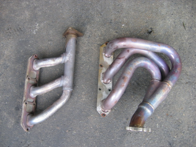

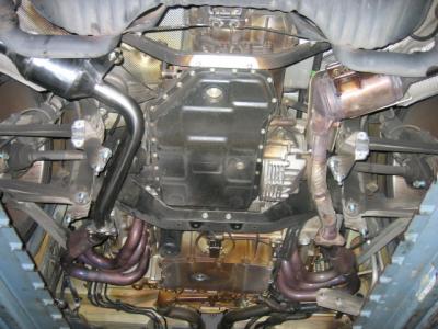

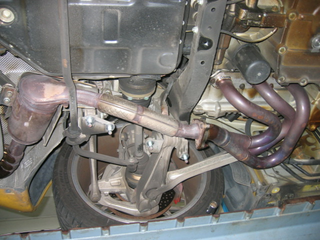

I'm attaching some before/after comparison photos of the setup and cat itself.
Points to note for installation :
1) You will require 2 U joints (left and right cat) for the connection between the cat and the muffler. The original connectors can't be used. Reason being the muffler pipe now slots into the cat pipe (cat pipe diameter is bigger when previously, its the same as before).
2) The left cat piping will hit against the anti roll bar during hard acceleration. During installation on the hoist, you will NOT see them touching each other. However, you will need to bend the muffler bracket to create more clearance between the anti-roll bar and the cat piping. Right is ok. I had to go back on the hoist twice to adjust the clearance.

Stock Headers : 4.4lbs
Dansk Headers : 7.72lbs!
But I guess the better flow and equal length pipes more than make up for the increased weight.
