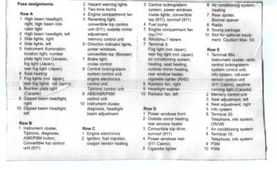

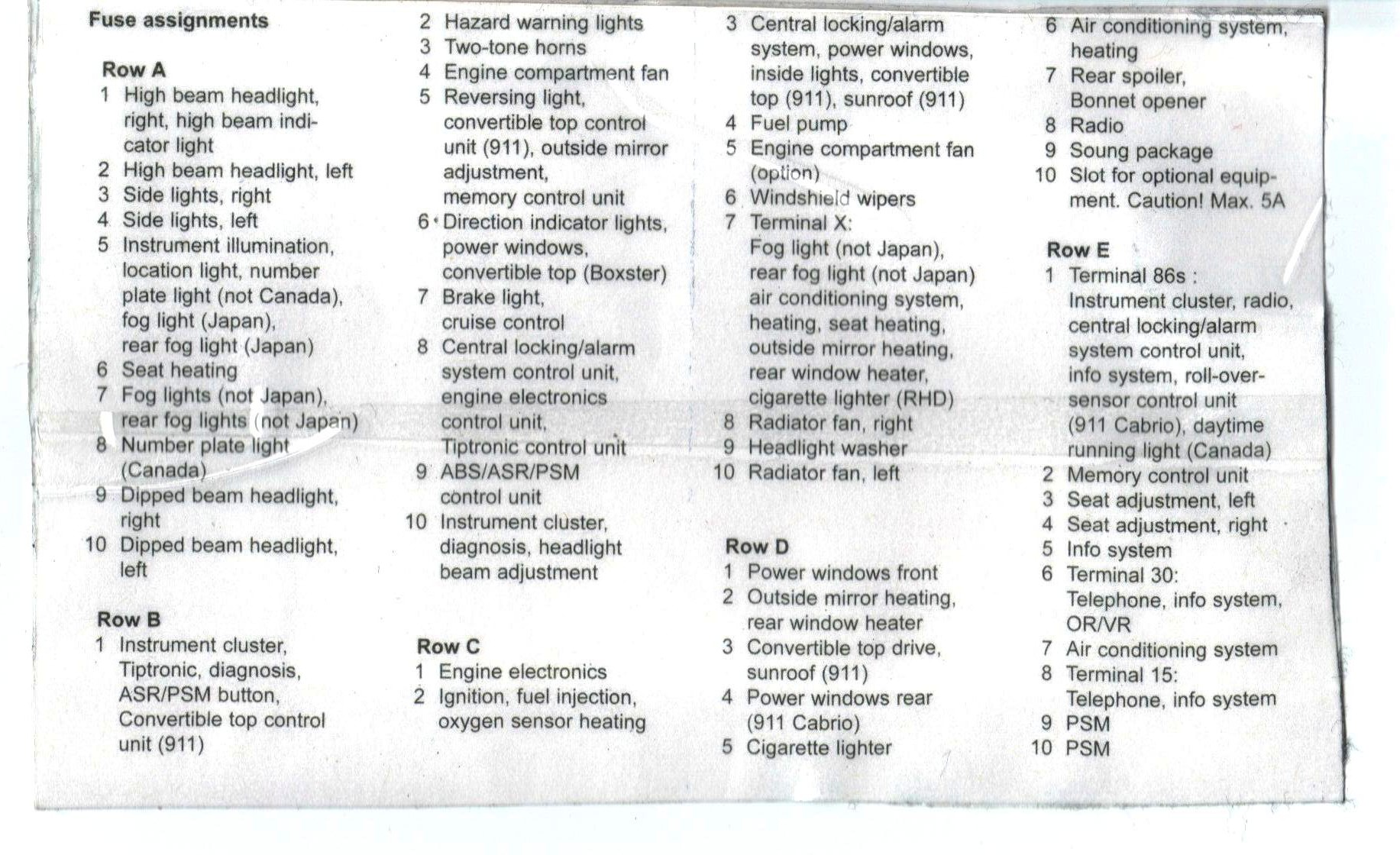

I have a question does the Immobilizer have a fuse? My car beeps when locking doors does this indicate that the Immobilizer is working?
This is for 2000, 996.

Going back to the question about fuses, I think you will find that there is a small fuse in the alarm module itself. May be worth checking.
