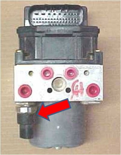

There is that there is a pressure sensor on the ABS manifold itself that may be incorrectly measuring pressure. The same Bosch module is used for some BMW's (and other cars) and that sensor has been known to fail. I have had failed sensors or modules that did not report errors to the OBD system so it would not surprise me that there is something that failed but is not being reported.
I would start with this pressure sensor and in parallel have the wheel speed sensors removed and cleaned. The wheel sensors pick up lots of ferrous material and can send the ABS module incorrect information. Here is a generic cleaning procedure for removing and cleaning a very dirty sensor but the main thing is to pull each one out from each wheel hub and removed the junk that is on them: http://autorepair.about.com/od/regularmaintenance/ss/abs_sens_cln.htm

Loren, he mentioned that the dealership checked and found no fault codes. I agree not to replace parts either without more investigation. I noticed that I cannot find a part# for the pressure sensor. Does that mean you have to replace the whole hydraulic assembly ($1800-3000) if the pressure sensor dies?
