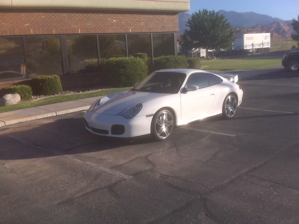

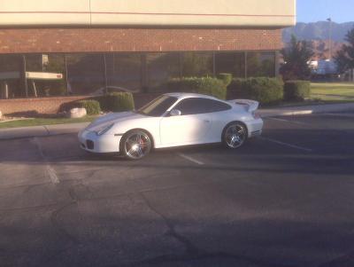

Hello all:
I have a 2002 manual C4S with 997 turbo look wheels 19x8 (235-35-19) front and 19x11 (315x25-19) rear. I currently have Continentals on it and the fronts are in great shape, but the rears are wearing the inside of each. I have TOYO T1R's coming. Question is there an alignment spec for more of a daily driver set up? Even though I like to drive it spirted as much as I can, it does get driven like a regular auto on the freeway. I do not track this car.
I would also like to put on some coil overs to lower the car about 25 to 30 mm what affect will that have on the alignment spec for tire wear.
I know currently the camber is just a little bit to negative according to the forums and that is the cause for the tire where. If I lower and put on the coilovers will I be able to compensate for the negative camber.
Would you sugest Coil overs or lowering springs?
My suspension is currently OEM?
Thanks for your help.
