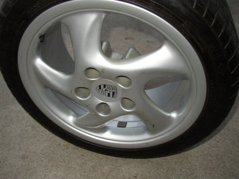

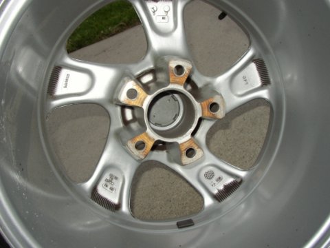

Here's some photos. Just says "Made in Italy" and what appears to be a date code for 1996..
I could not find a part number on the side.

If they say Italy on the back side then they are definitely look alike knockoffs.
Sorry you ended up with these.
They are not going to be worth much unless you can find someone with an older 911 that likes the look of the newer wheels.
Any chance of going back and finding the guy you bought them from.
I paid $1200 for turbo looks with brand new Dunlop SSRs on them, but they were factory original.... those wheels that you have probably are worth somewhere in the $500-600 range...Maximum. Maybe less

I believe one or both sets of OEM wheels on my Boxster said made in Italy. One of which were the real OEM Turbo Look 18" wheels. The real test is a Porsche part number. Also, since Porsche didn't make Turbo Look wheels in 17", those are aftermarket, but there are numerous licensees of that design. I will agree you got ripped off. One of my (many) sets of wheels were Mille Miglia Cup 3 (17" Turbo Look licensees) were less than $1200 new--and they fit better than either the OEM Turbo Looks or the 17" Boxster wheels. You got a raw deal. Best of luck!
Yeah, and you got a sweet deal. Should have sold them for $1600. :oops: When do I get to see pics?
