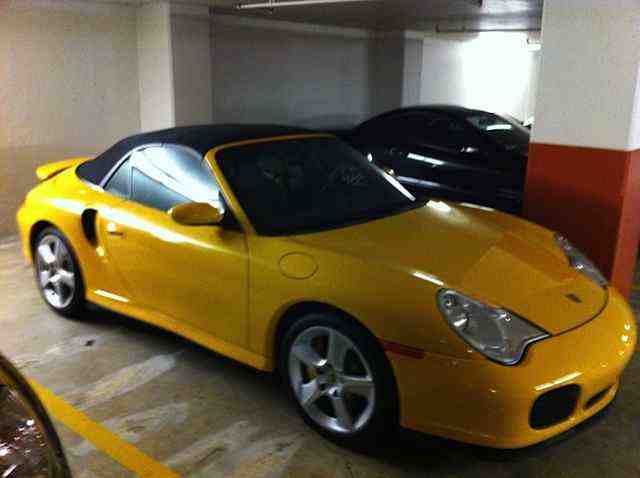

Congratulations on your new car, Post some pics.

As soon as I figure out how to post a picture, I'll put one up. This is an awesome and advanced site, but I just haven't figured out how to post a picture? Clues? And I was a programmer for many years :-).
I'll have to drag my real camera out soon once I get it detailed...
