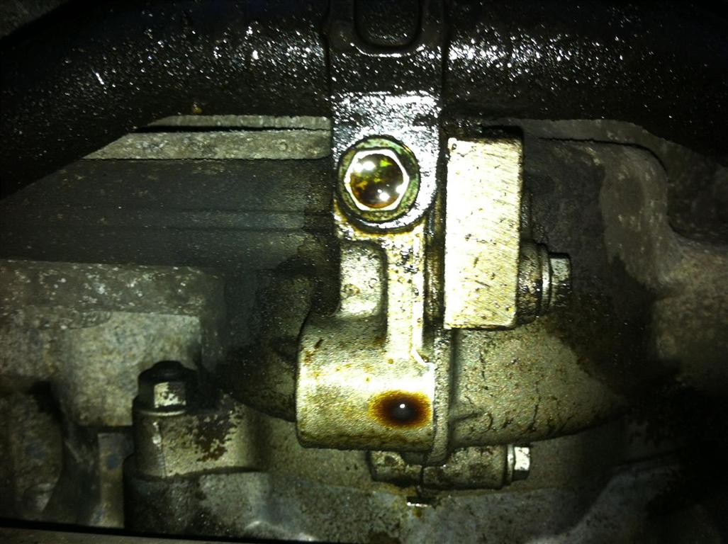

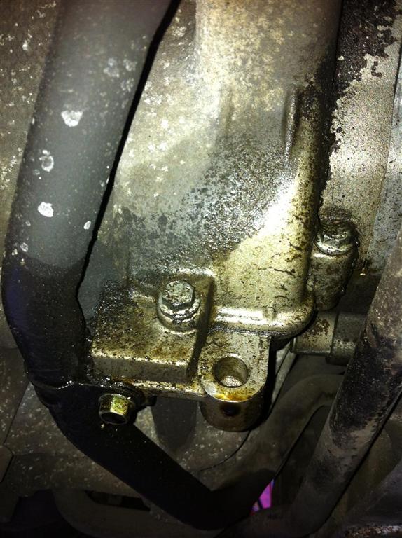

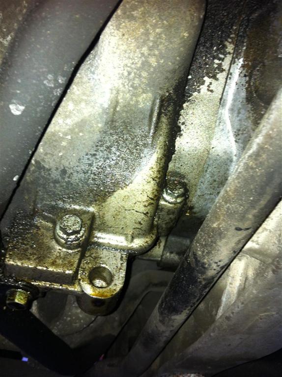

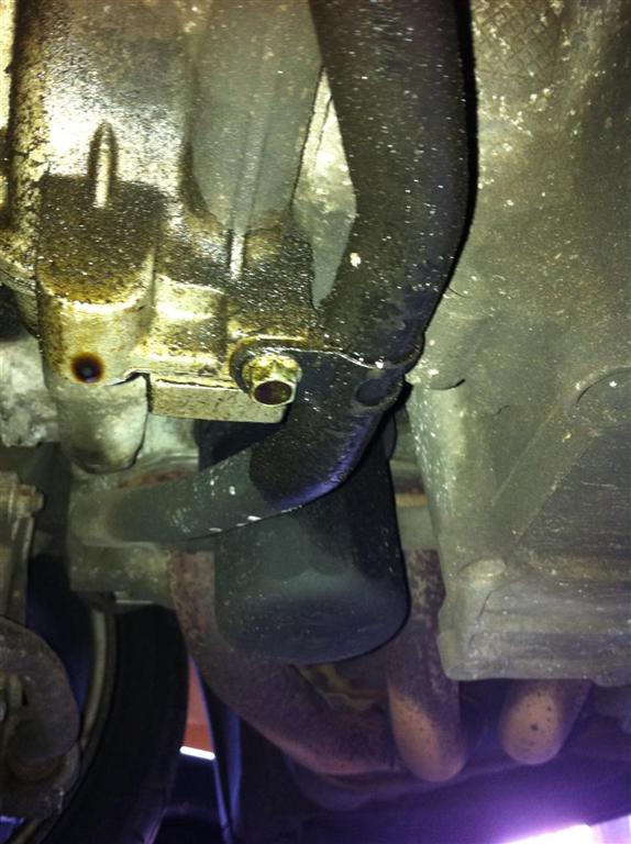

This weekend the car was up on a ramp so I took the opportunity to take a look underneath and I noticed that there appears to be some oil visible where the engine meets the gearbox. Dare it be the RMS and should I be panicking?
I have attached some pictures for people’s opinions. I am not going to panic, the car hasn't lost much oil and doesn't appear to be leaking on the ground
Look forward to your opinions. Thx

Yes to me that looks like you could have a leak from the bell housing. The second, third, and fourth pictures are pretty revealing.
Either from the RMS seal or the IMS seal, or both!
I wouldn't panic though, certainly it should be addressed, but chances are the car has been like this for a long while. Does the car use a lot of oil?
You can clean the area and see more precisely where it comes from, or remove the transmission and inspect/repair those seals.
Hope this helps.
