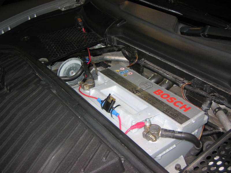

I have a CTek XS3600 conditioner. I have a permanent connection to the battery on both my cars, and swap it over to whichever car I'm not using. I run the charger cable between the front lid and windscreen, and plug it in to the socket, which it cable-tied to the plastic cover.
post-4000-0-59971700-1336220010_thumb.jp

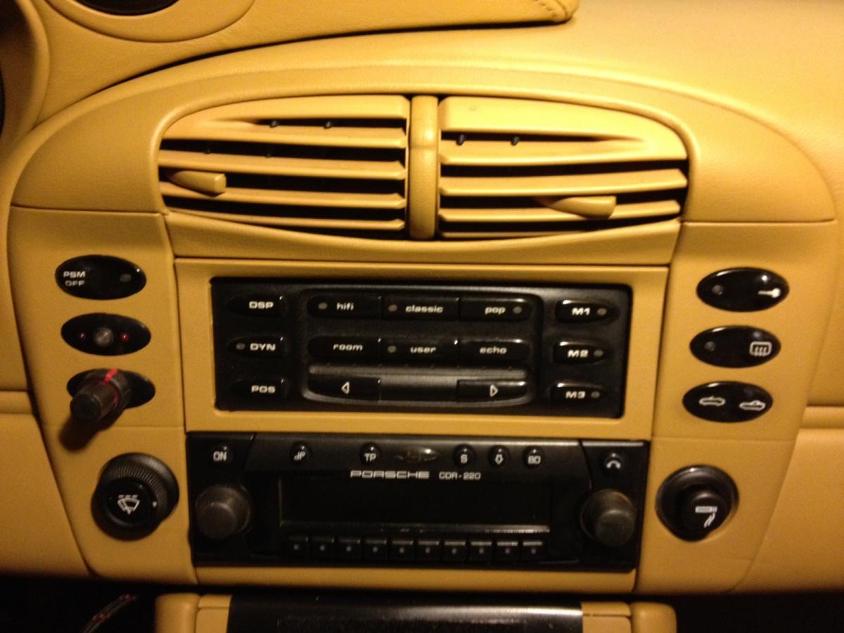

"There is a $20 retrofit kit to change the lighter over to US specs in about 10 min"
JFP in PA, I got the lighter adapter for my Birthday. It came in two small boxes. I thought you stated it would take 20 minutes to change out and I see you say only ten minutes. So obviously I am missing something as I looked at the existing one for over ten minutes and did not see any obvious way to remove it.
Mine is in the right side lower portion of the "Three Part Horseshoe." It is on the right side lower section of the one piece side trim that also houses the switches for the convertible top up/down and so on.
Does this trim piece just pop off?
-Don
Yes, it just pops off. If you need to "help it" come loose, try sliding something like a tongue depressor under the edge to get it started. Once you have the trim off, it works like this:
Don't be concerned if you need to snap off the old bits as you will not be using them again...........
Edited by JFP in PA
JFP in PA,
Thanks !! That brightens up my day,.
I got the trim piece off. Always a challenge worrying about nicking the leather covered piece
I got the cable plug running to the lighter disconnected.
I got A off.
I got B off - You need to slightly lift it along its lower long side. This helps pop it loose from the snap rail it is connected to . Basically you rotate it clockwise. I thought I would break it but I guess this is how it is made.
Now I can't get the new lighter installed ! It looks like I need to hog out the circular hole that the old one was in. It is very close to snapping in but it feels like I will break the trim piece if I push any harder.
I got the hole enlarged and now have the lighter installed.
Thanks to JFP in PA for all the help !
Don
post-80079-0-34516600-1338819025_thumb.j
